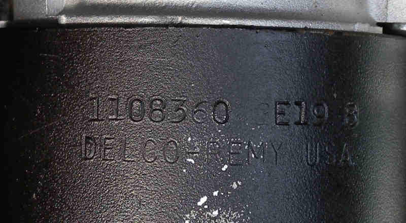

Hello,
Ran across a starter with the number 1108360 E19 8 and could not find it in my books. Anyone know what the usage is?

Greg, you sure that "0" is not a "5"..???

Here is a pic

-----You have seen the ghost "2" in front of the "E" havent you??? That 0 looks pretty deep compared to the other 0, but I dont know if that means anything, and the E19 8 appears to be very deep too.......Bill S

The 2 is the year of mfg., 1972?
Format for starter dates is YMDD. The 8 isn't part of the date.

Those were intended for 1969 Checker Cabs w/V6 230-250HP motors originally.

This was a reman that did not have the hole in the case for the side brace. Saw the date and figured I see what it was from. Even with the ghost "2" this is probably an original stamp.
