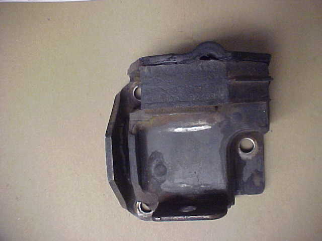

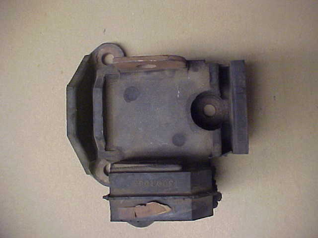

The "J" shape cut out is in the rubber, not the metal. I will try to post pics tomorrow.

Default Re: 69 L72 Motor mounts
Big block mount
Small block mount

if you look at the other side of the mounts ( that faces the block ) the SMALL BLOCK mounts have a ''L'' shape formed into the metal, while the BIG block mounts have a '' T'' shape.....IMHO.......

Well, thanks for the info. I guess my NOS "big block" mounts are really small block.
