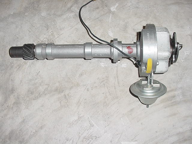

I just aquired several NOS parts and I have a NOS distributor with the points covers with part number 1111492 and date code of 9-F-11. Does anybody know what this is for I have not been able to find it in any of my parts books?

I show that as a 1970 Passenger car with 400/265 standard trans.

The number falls between 2 69 Corvette 350/350HP distributor numbers.

Rick is right, I just looked in the 70 Book and that is what it shows.
