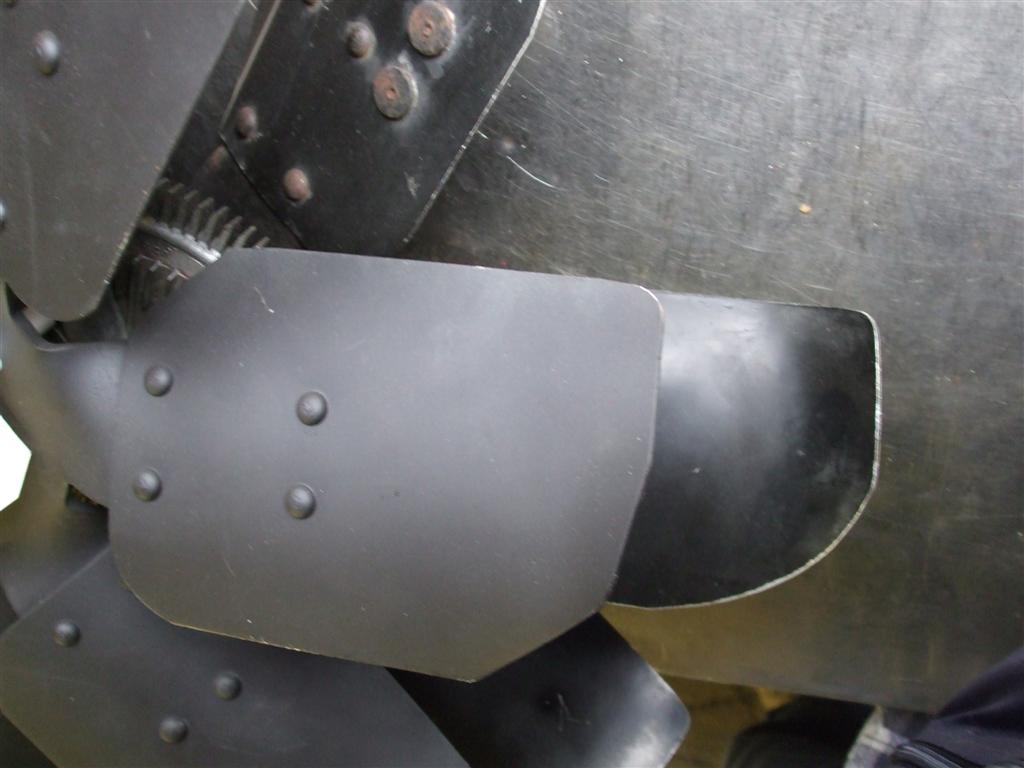

Can someone answer this question Yes or No, with certainty. "No ls6 with a 331 rear and a non heavy duty 3 core radiator left the factory with a #772 fan" Thanks

Never say never! Chris White and I have discussed this many times. He is correct that the buildsheet specifically calls out the 064 fan and NOT the 772 fan. I on the other hand have personally inspected at least 3 supposed never molested LS6's with the 772 fan. We all know that the assembly line has had to use other parts when the specific part was not available and I believe the 772 fan could be one of these. Many used to say that the ground and factory restamped CRW rearend was a forged restamp. Now we know that the factory did indeed grind and restamp these for reasons unknown so NEVER SAY NEVER.

The 772 and 064 fan are very similar to each other, other than the tip design which I believe was done for noise reduction so neither an upgrade or downgrade in my opinion. (Rick Peters photo)
