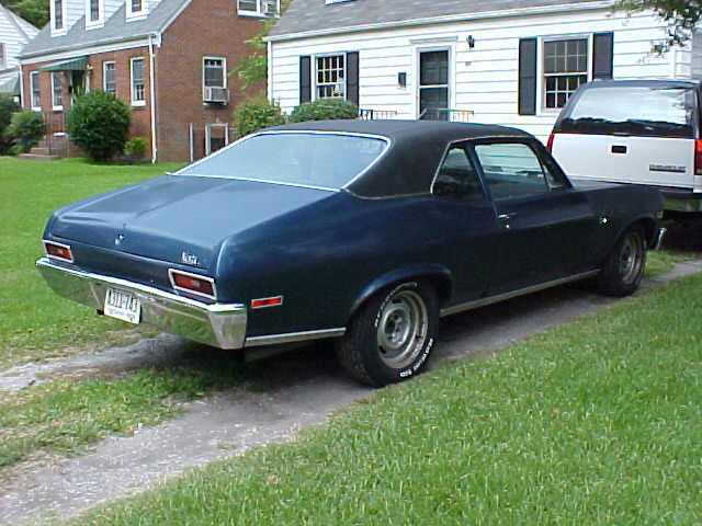

...Okay guys....I got it home...I will be taking some photos tomorrow....Here is what I got..
...1970 Nova, built 350 motor, aftermarket aluminum intake, POWER ASSISTED FRONT DRUM BRAKES, 350 emblems on the fenders, "11427" on the cowl tag, FRONT AND REAR SWAY BARS,
..15X7 RALLYS, 10 bolt rear, bench seat, auto. on column,
..get this....FATHOM BLUE...WITH BLACK VINYL TOP...
...built 6/70 ...I will get cowl tag info an photos tomorrow
..the one question I have ...are ALL 1970 nova's with "11427" on the cowl tag "SS" models?...or does that mean it came with a V8?
....Oh, it has power steering and factory a/c too...

1= Chevrolet
14=Nova, V8
27=2 door coupe
The only way to verify SS is if you have build sheet with ss code or if engine #'s match vin. Certain engine options required ss package.
