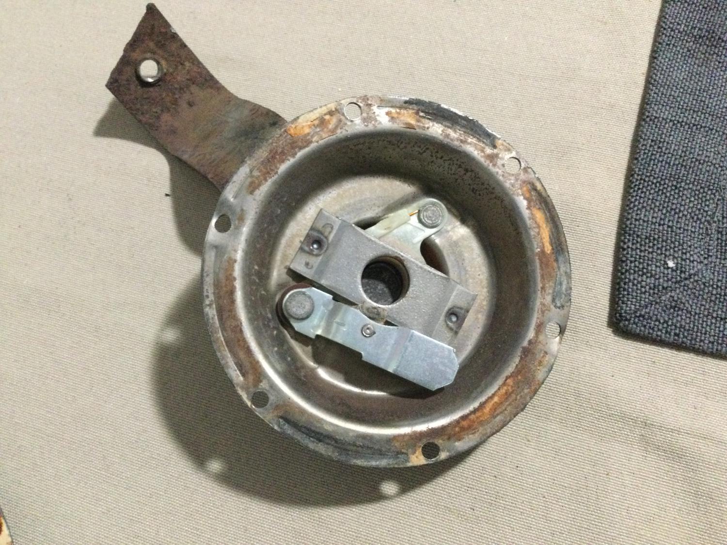

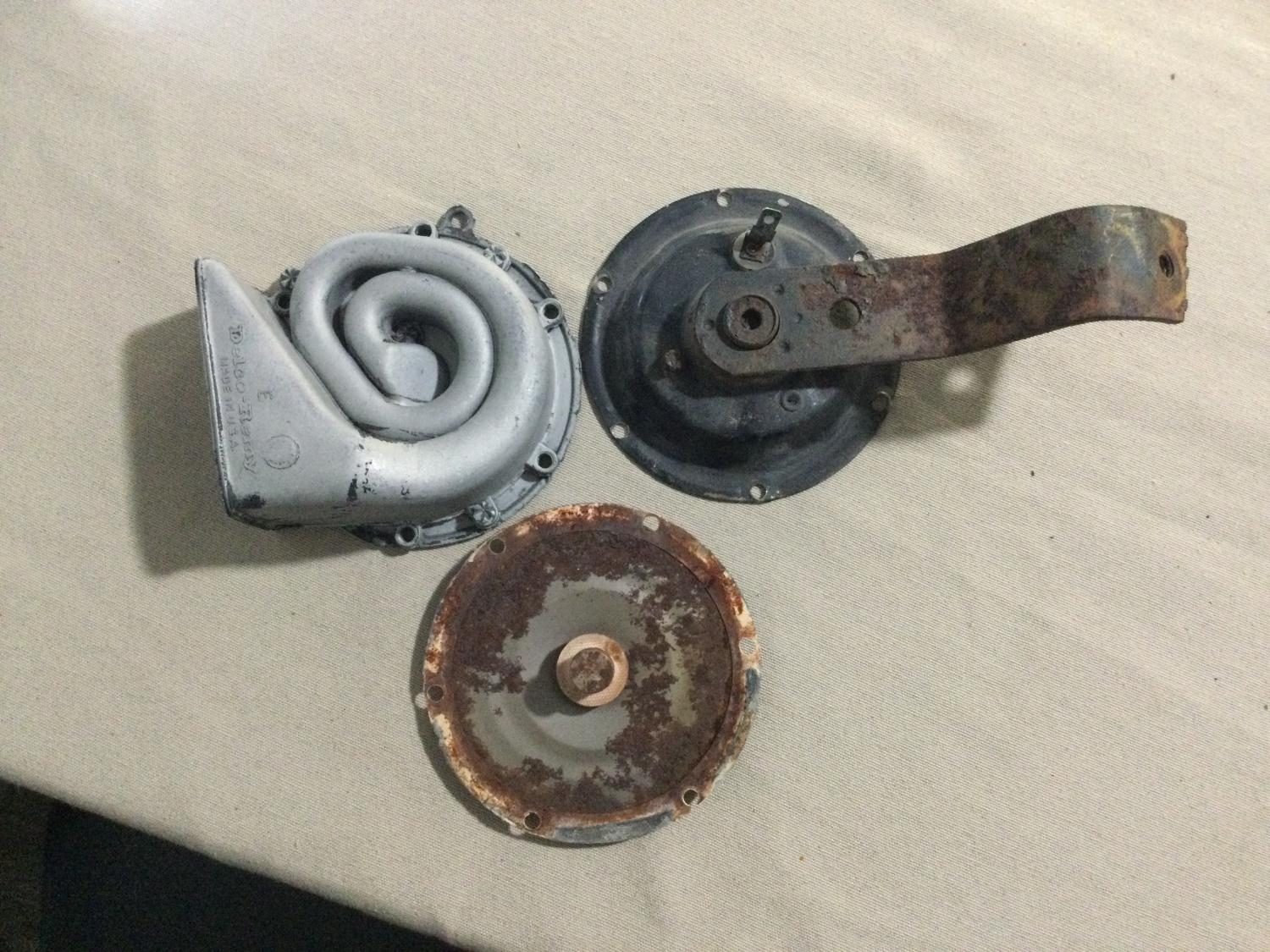

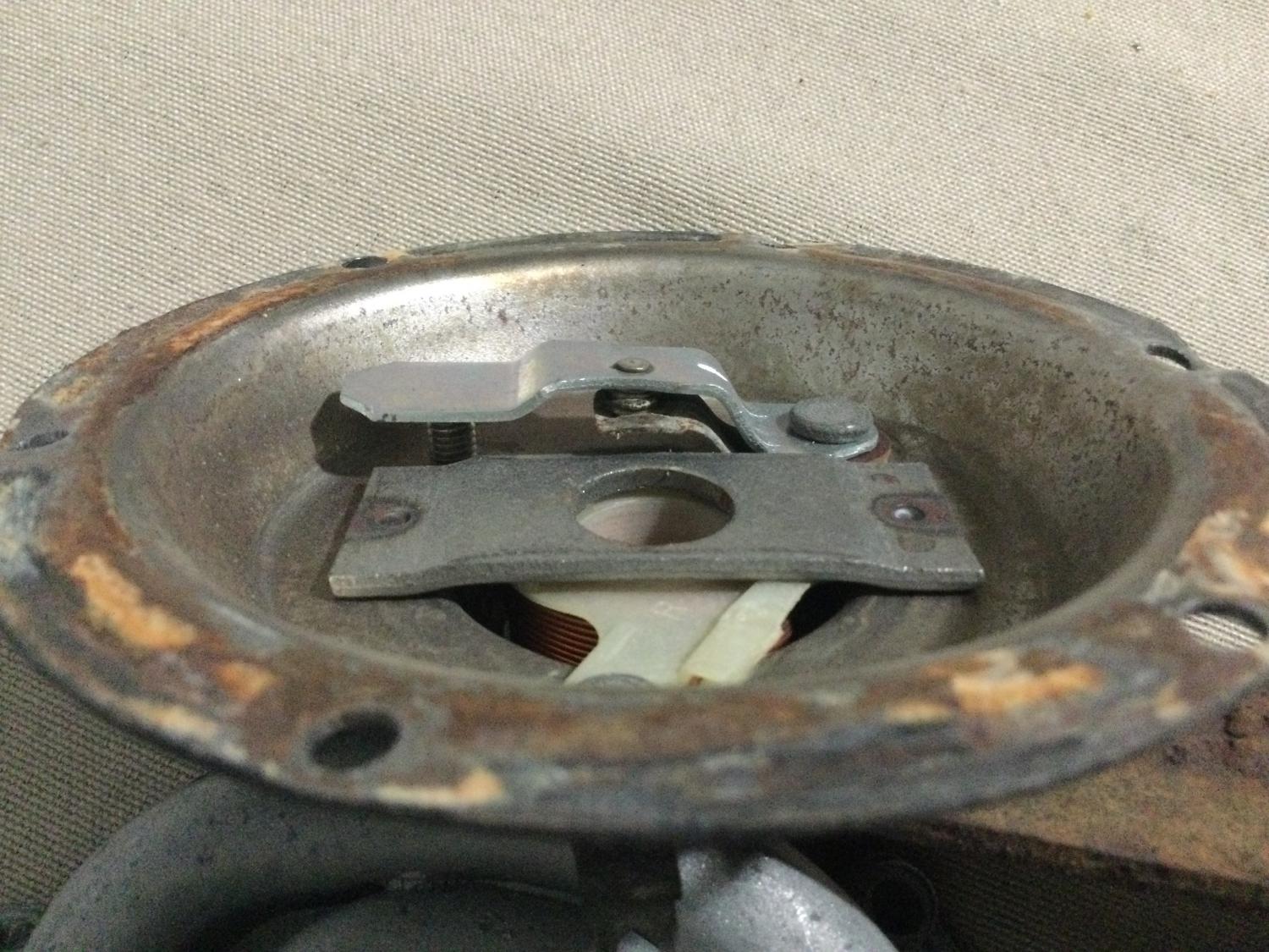

If you’re sending them to Gary, just do it. Rust is only 1 of the factors the cause the horn to fail, but not the primary IIRC. Moisture also causes corrosion on the points assembly. Considering it’s mounted on the front where it’s attacked by rain, snow, sand, and everything else, I’m surprised the last as long as they do. I’ve attached a few pictures of a horn that Gary started but didn’t finish because a found a matching date coded horn.
