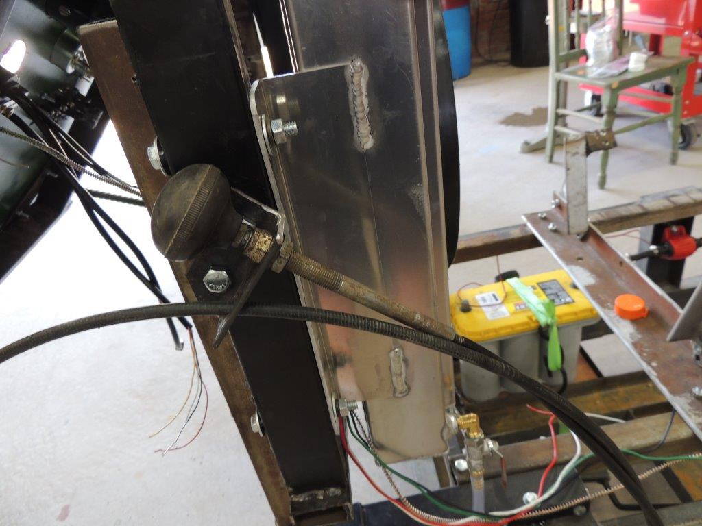

I know at least one member has one of these. I was going to build my own, as I have all the steel I need. Bought a bunch a few years ago at a surplus auction for about 5 cents on the dollar. Building one for just Chevy motors would be pretty easy; but I need to accommodate an SBC, a Supercharged Studebaker V8 and a Ferrari V12. That will be a bit more challenging.
But, the older I get the less time I have, and frankly, things I could knock out in a weekend when I was SuperDave's age, take longer now. So, I was considering purchasing one.
Looks like they may be out of business. Anyone heard anything?
I did request a quote from a third party vendor, but haven't heard anything yet.
Attachments - The Supercar Registry Throttle.3.jpg Throttle.2.jpg Throttle.1.jpg RadiatorDrain.2.jpg
