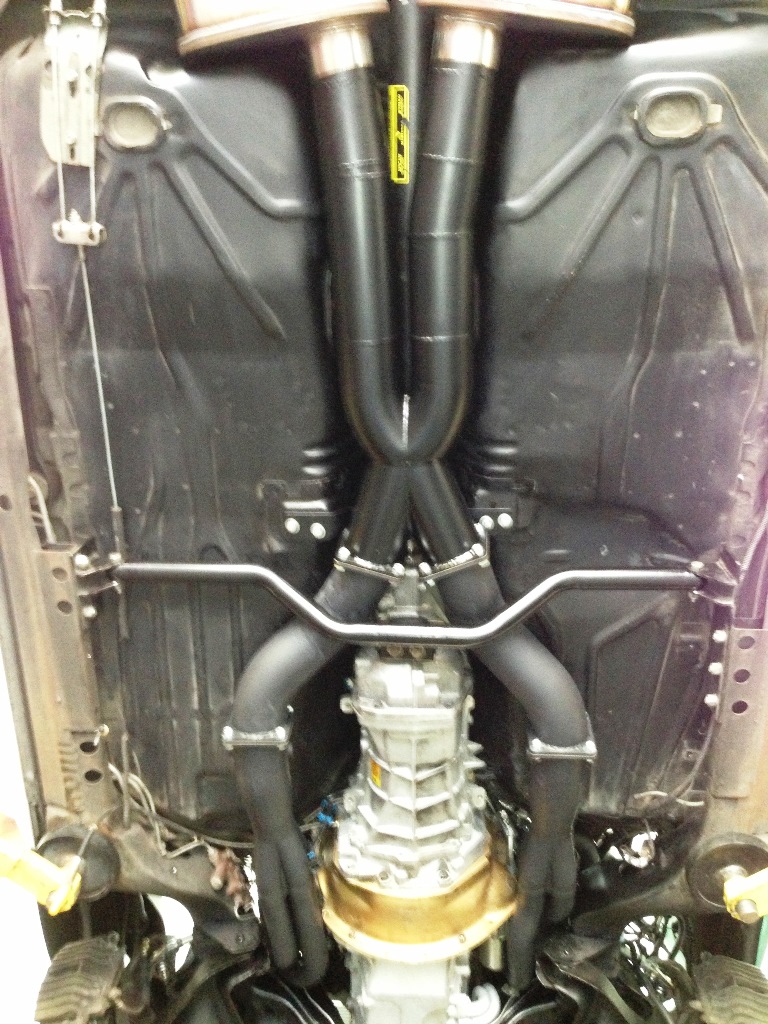

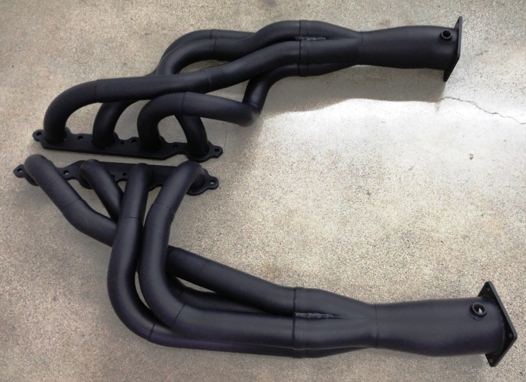

Here are my hand built triple stepped 1-7/8" to 2" to 2-1/8" true equal length primaries (+/- 1/16") 27" long with 4" diameter merge collectors and 4" exhaust system that I fabricated for my 700+RWHP NA LS7 Z06 crate motor in my '88 Monte Carlo SS.
