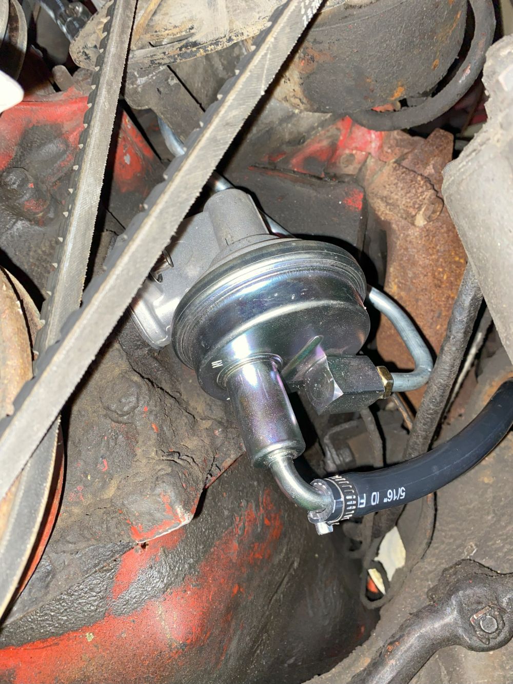

That bracket may have held a fuel filter, as the fuel pump is on the left side of the block and the line came up to that location. If I recall the fuel hose now goes to the right for the engine to run on a remote tank ?
