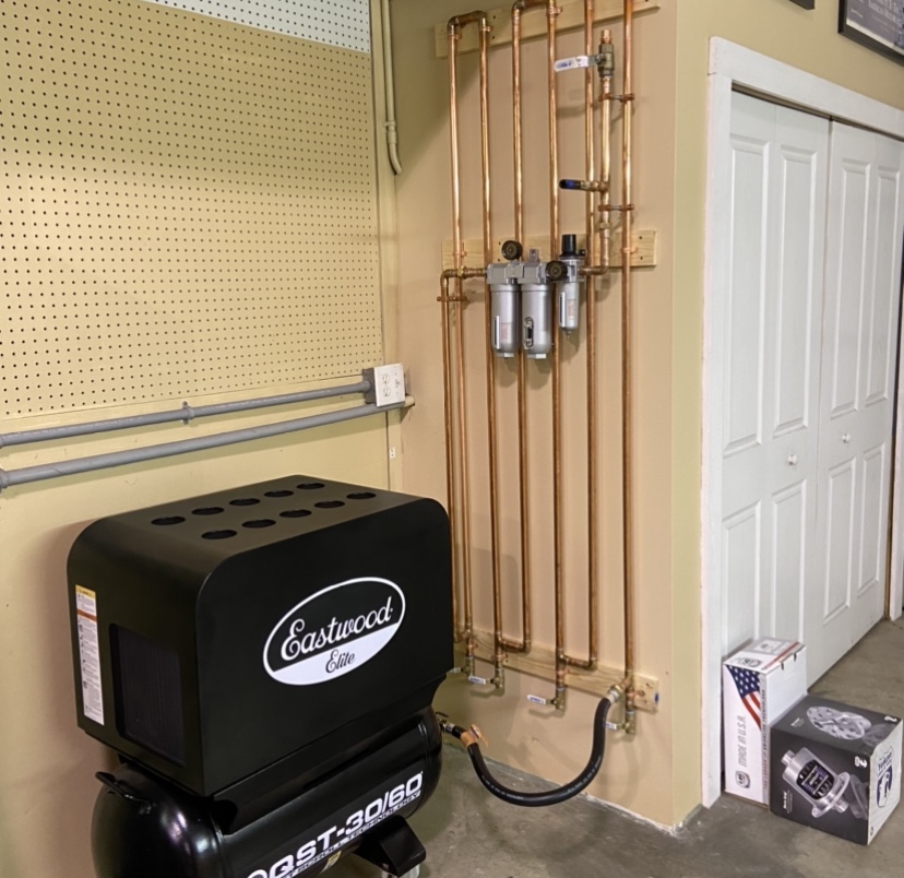

Looking for some opinions and recommendations for air compressors. Primary use for air tools and other general uses. Looking for a quiet unit or do most of you install them outside in a separate room?
Thx in advance
