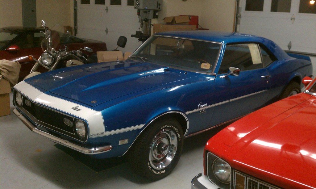

Hey guys, i just bought an original paint, 1968 camaro ss 396/375hp 18,000k miles. m22, with factory 4.88 gears. The original motor was blown up in the day and switched out the block with a 69. How can i identify this car is a real l78 car? It still has the original window sticker (i believe) stuck to the dr side glass. It looks super vintage, options including a 375hp engine and 4.88 ratio rear end. If anyone can help identifying this car, let me know. THANKS!!!!

rear end and side shot, ss emblem is missing, and the hood is day 2, suppose to have ss hood. If you notice on the window sticker "floyd foren" dealership, and the decal still on the rear bumper
