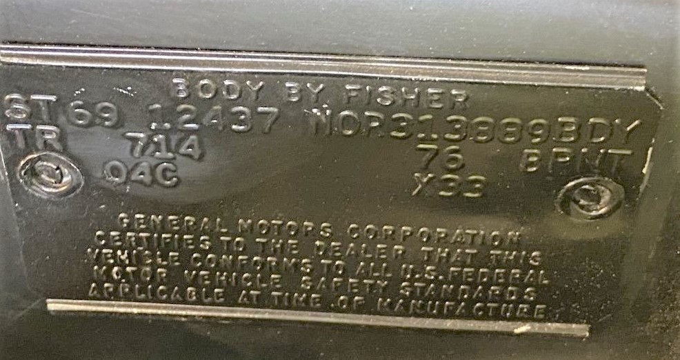

What are your thoughts on this Trim Tag?

Rivets indicate it has been off the car. Would prefer a better pic but have reason to question it.
VIN tag has definitely been off the car, dash top replaced. Proceed with caution.

William
Does this help ? I lightened it up a bit.

Not original rivets so I'd have to concur that it's been off the car. I kinda like the color options and interior but then I am biased.

Best pic is straight on. Looks like the characters were lightly sanded to look worn.

Georgeous looking car. Only about 700 builds away from mine. Tag information lines up with mine but as has been mentioned may have been off the car.
