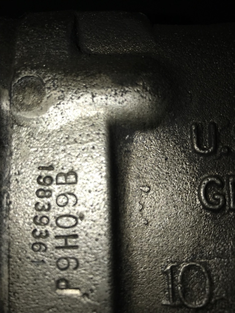

P9H09B 19839361 See picture..

I think you mean 19B39361X
You are missing a number and the 8 is not the one missing...
the 8 represents a B or is a B for Baltimore.
1 represents Chevrolet Motor division
9 Represents the YEAR
the next digit is an ALPHA character for the assembly plant
then the serial number is the remaining 6...
Check the VIN and report back.

That is all there is on the pad. Upside down from each other. I have a picture on my phone of it if I can text it to someone that can post here from there phone..Tks

How about
P 4-sp Muncie
9- 1969
H-June
09- Ninth Day
B- M-21
19839361- Service replacement ???????

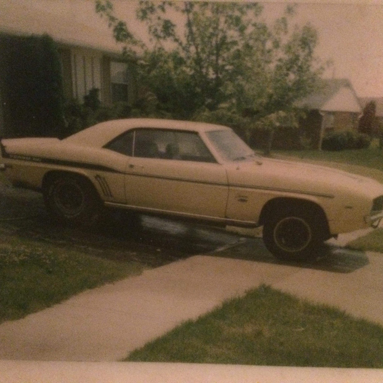

I was hoping the vin was on the pad to see if this car was known. It was a DY car.

Would likely be a Chevelle since it is stamped with a Baltimore B code.

It came out of a 69 DY Yenko Camaro around 1985.

From the CRG site
P is for 4-sp Muncie
9- is for 1969
H- is for month of June
09-is for the Ninth Day
B- is for M-21
I don't know what the numbers stand for...19839361- Service replacement ???????

I do not believe it is a vin number
