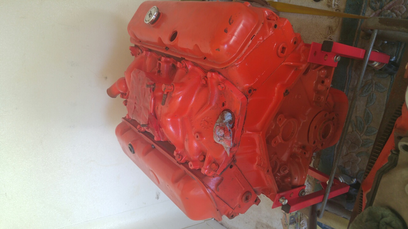

Hi,I posted this in the Impala net and they tell me i possibly have a COPO motor any help would be appreciated.
Hi,all I purchased an engine recently 1968 cast# 3935440 It has a really weird suffix T0419I5 yea a 5 and the vin# 18D166508 I see broach marks in the picture on the deck pad so i believe it was a factory stamp.
I believe the D in the vin is Doraville GA internet says Impala was building cars there from 65-70
my info could be incorrect so any help would be appreciated..
Thanks 964IMPALA
One of the Replys i got from Impala.net forum
photo attached..

I don't believe Copo 9627 was a performance Copo # and more likely a fleet specific transmission and/or rear axle application?
Some listings note '67 Camaro Suffix FB w/ Copo 9627 which was a 250ci 6-Cyl. so again unlikely anything to do w/ performance?
Best always keep in mind Chevrolet's Copo system has been in place since 1958 or earlier and used multiple times more for fleet orders than performance applications...so, lots of parts to be found from Copo Taxis/Bell Telephone trucks etc.

Just courious, is it a Factory 4 bolt block? Or 2? Thanks Rob

Rob,I don't know that I just bought the 2 motors yesterday still on my trailer i had shoulder surgery a week ago so will be a few wekks til i get them out.

Take a pic of the side of the block above oil filter.

Darrell,you wanna see the plug size? or see if a vin#or date code?
be a little more specific
Old 06-12-2018, 07:02 PM
cook_dw's Avatar
cook_dw cook_dw is offline
Join Date: Oct 2003
Posts: 4,389
Thanks: 674
Thanked 1,726 Times in 660 Posts
Plug size
