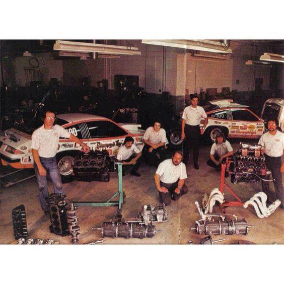

Hey gang,
I was contacted by a guy who's a friend of a co-worker in regards to building a Ronnie Sox tribute racer. He's not sure what he wants [68 or 69 RR.... maybe a 70 Cuda] but what he does want in it is a new-gen Hemi and a Lenco 4spd. When he asked me about that transmission, it was met with a combination of the RCA dog stare and the look you do when the Victoria Secret catalog shows up....drool... smiles...gaping mouth. You know.... if you like that sort of thing. But from a technical standpoint, I got nothing. Done some research on how they work and after that, realized A: Not cheap.... and B: So freakin' cool I gotta build a car with one.
He's really only using the car for the strip, but maybe street use too. But from talking to him, its really only going to be a fun Friday night strip car. Can't wait to spend someone elses money on my addiction!!
So.... anyone have experience with them? Thanks folks!
Cheers
Dave
PS: I spelled it wrong just to show I really don't know anything about them!
