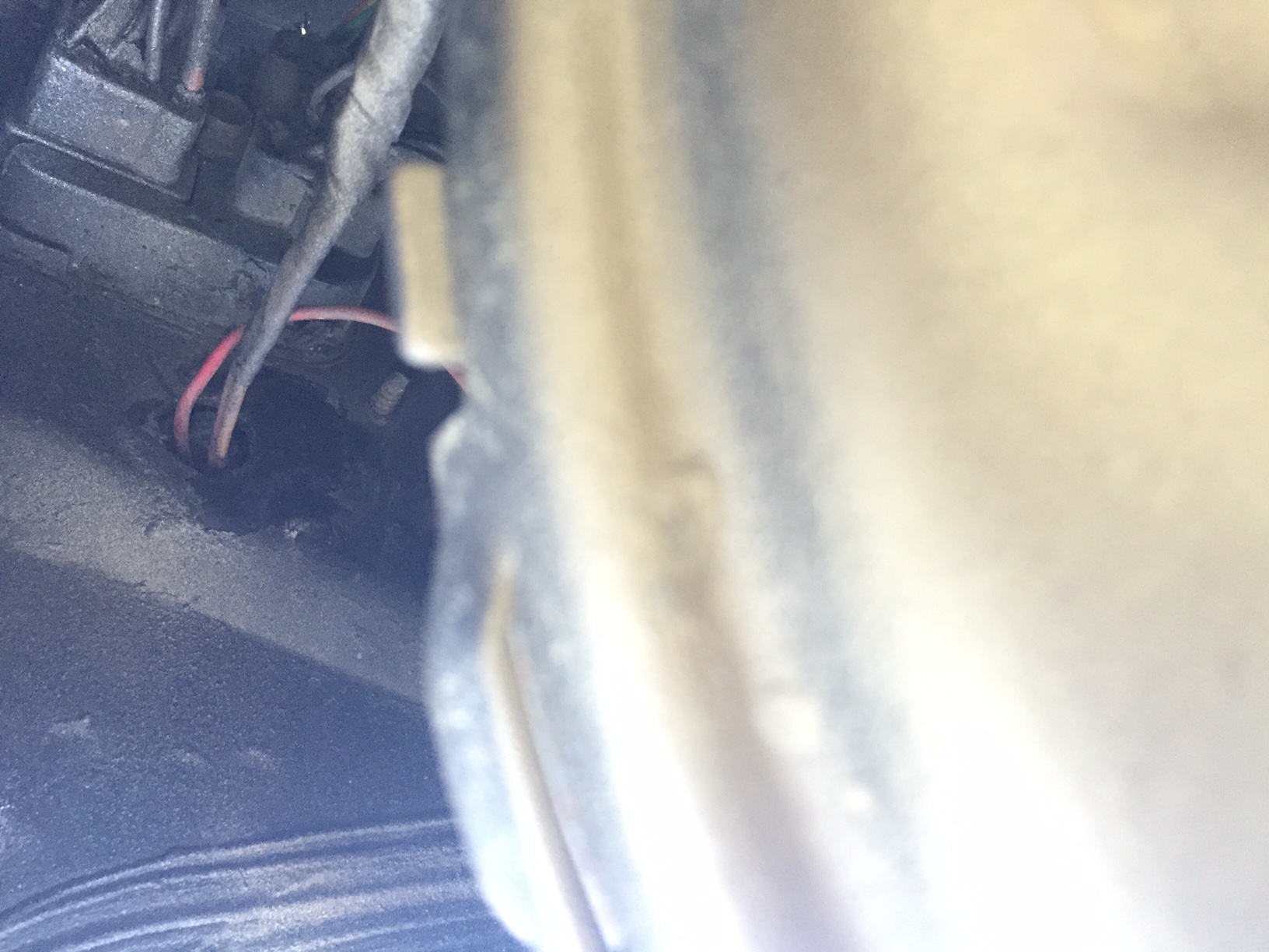

New here fella's and need some help trying to figure out if this car is a Copo or not. Here's what I have found so far.... Ive attached some pictures as well.
X44 Tag
Non Matching 4spd but looks to be a factory 4spd car
Factory disc brakes (factory pedal still in car)
Dual Exhaust Hangar
Has Functioning Cowl hood
Hole in fire wall for cowl hood wiring
12 Bolt with 4:10 gears (suffix codes have been grinded off, really weird)
5 leaf springs
Harrison 4 core radiator with angled neck
Thoughts? Anyway to get proof without any documentation?

Hard to see but is the assembly date 04E. If so the body ID# is very close to my car with a 05A date. That tail pipe adaptor plate is nothing close to anything I have seen. Take the heater core hoses off so we can see what they look like. Is the gas petal still with the car....what does it look like?

If this is the car from a michigan dealer, it is questionable. The hole for the wiring is looking not correct, but would need a better pic of the hole. And removing the hoses would be able to tell if someone just hacked it into a big block heater core from a small block. This car is 50/50 to me and would have to see the car in person to make an accurate decision on if it is real. The build date is 04L.

I don't like that cowl induction hole on the firewall at all.
