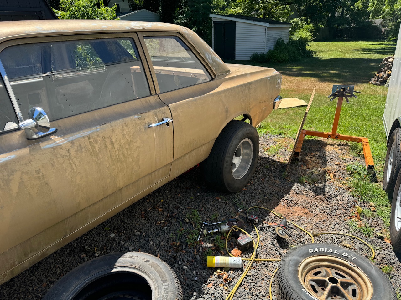

It’s all coming together. Narrowed truck Dana 60 swapped in with the perches up top.

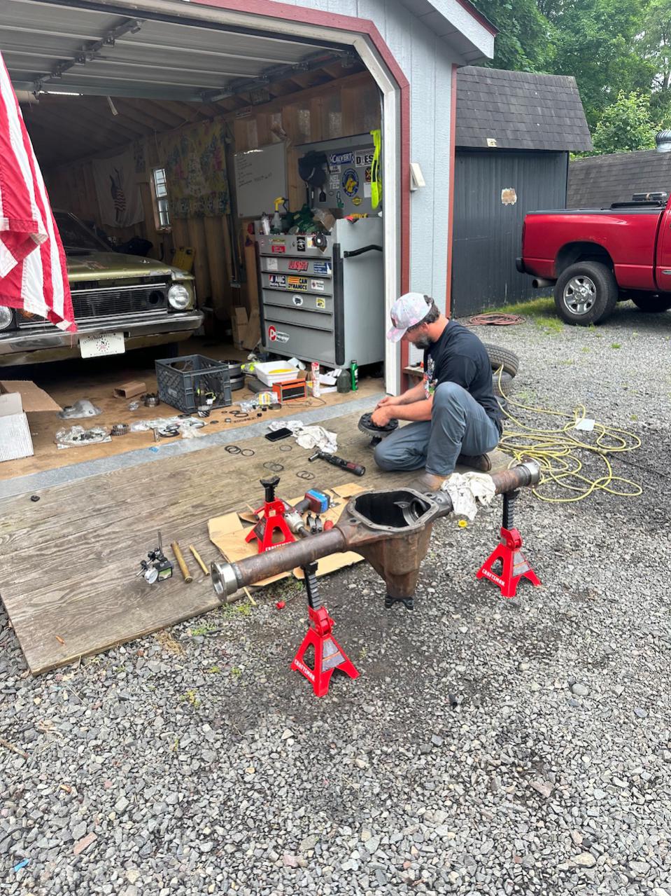

Not sure if I should start a build thread in the AMC section for this. But here’s where it currently sits. Ended up removing 3 leafs from each side as the leafs speedway provided were way too heavy. The rear is sitting spring under. With 5.13 gears and a spool.
Built the rear with my dad on Memorial Day. Measured for the steering linkage. Pretty soon it’ll be moved into the garage so the bodywork and other repairs can start. I also need to figure out the Ladder bars for it.

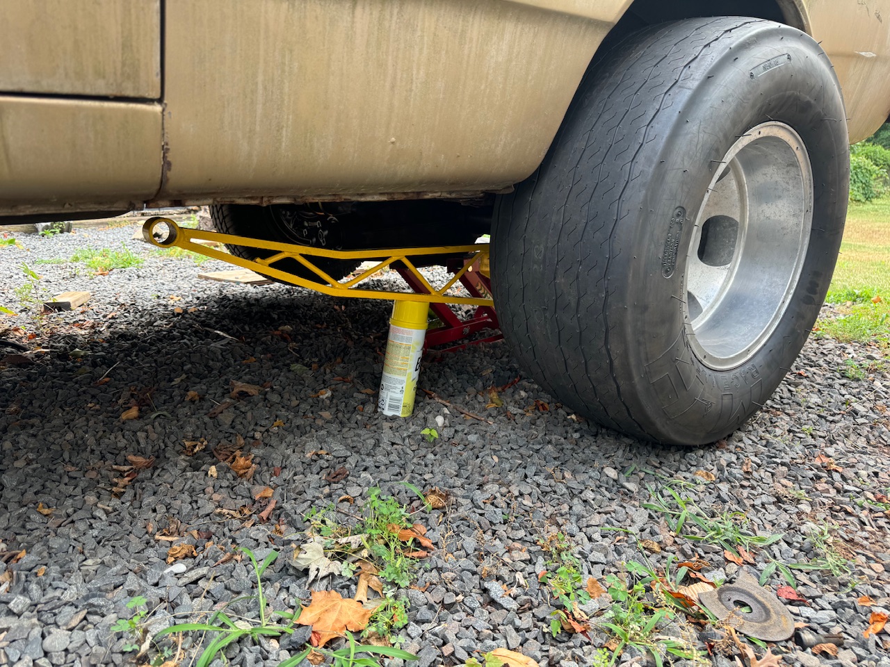

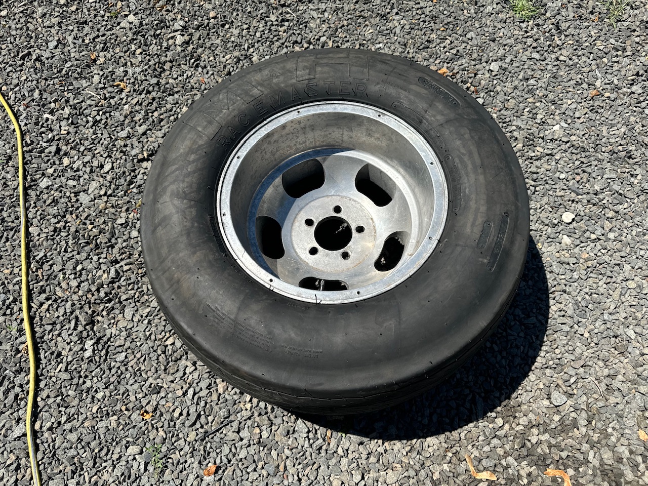

GM A body Lakewood ladder bars and N50’s on 15x10 slot mags look good. I think it’ll fit the era I’m going for. Now I wish I could find a used GMC 671 blower to rebuild.
