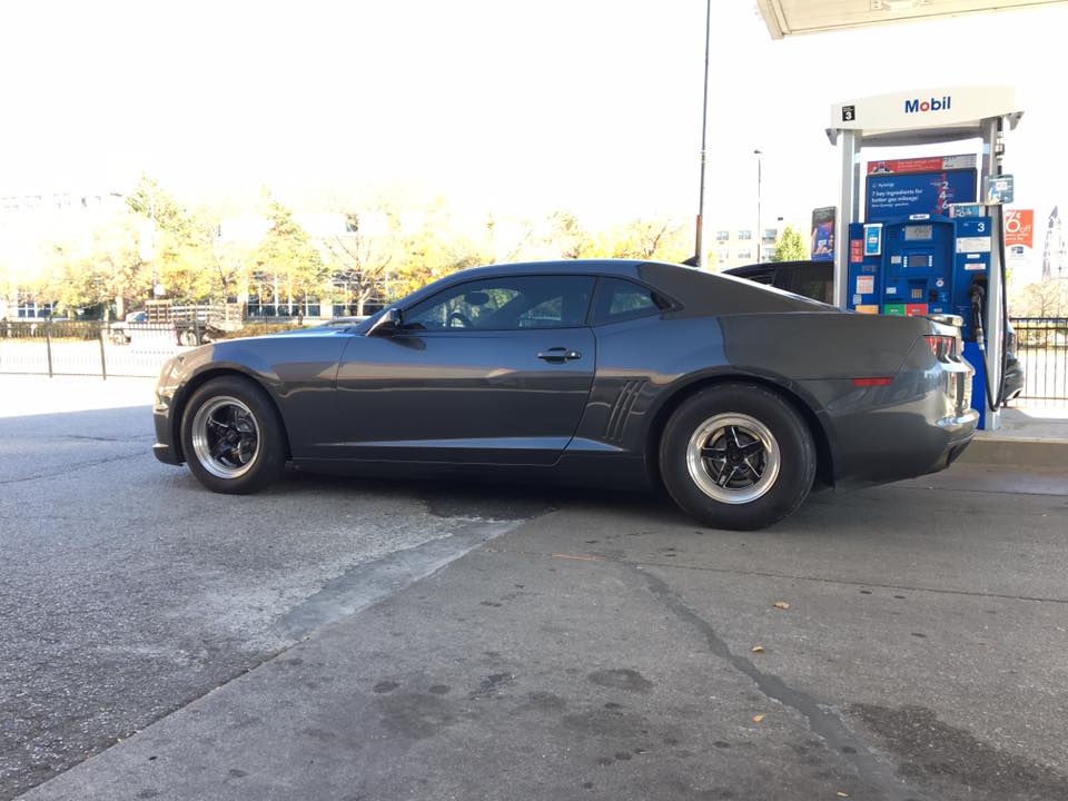

Here is my daily driver, it's a 1SS RS/SS L99 car. I bought it in 2013 with 16K on it, now has 49K.
I wrote some magazine articles while I was modding it:
https://www.motortrend.com/how-to/12...or-the-masses/
https://www.motortrend.com/how-to/13...masses-part-2/
In final form, the mod list is:
Vararam OTR air intake
Intake manifold has been rod modded
Hooker 1 7/8 headers + 3" full exhaust
GPI VVT SS3 camshaft
Bo White ported heads, not milled
BTR valve springs
Circle D 4C converter
ADM trans cooler
160 thermostat
GM 3.91 gears
G-Force HD axles
Eaton TrueTrac differential
BMR 15" suspension conversion
Carlyle rear drag brakes
Weld 17x4.5 / 15x10 RTS wheels
Mickey Thompson SR 17x6.00x28 front tires
Nitto 275-6015 drag radials.

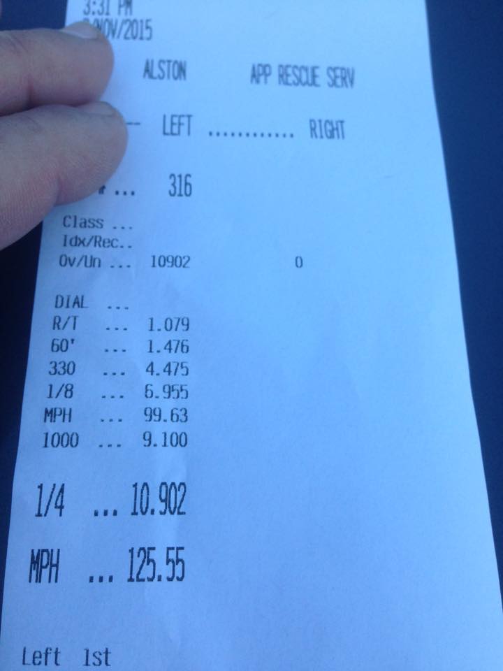

Went a best of [email protected] on motor, pump 93, on 28x17 Hoosier slicks.
