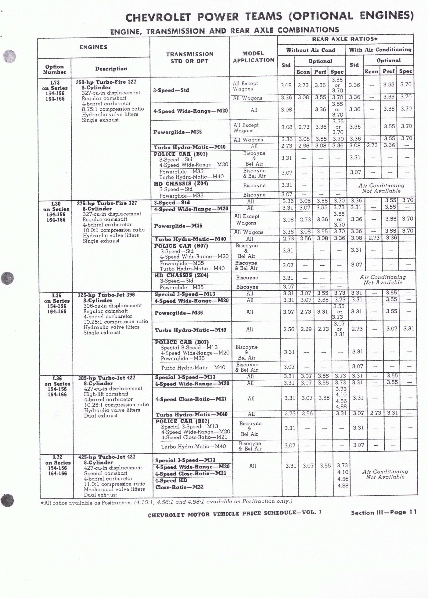

I found a 1969 Power Team chart and it shows 3:73 as the highest gear ratio
you may have needed the COPO 9511 to get the 4:10

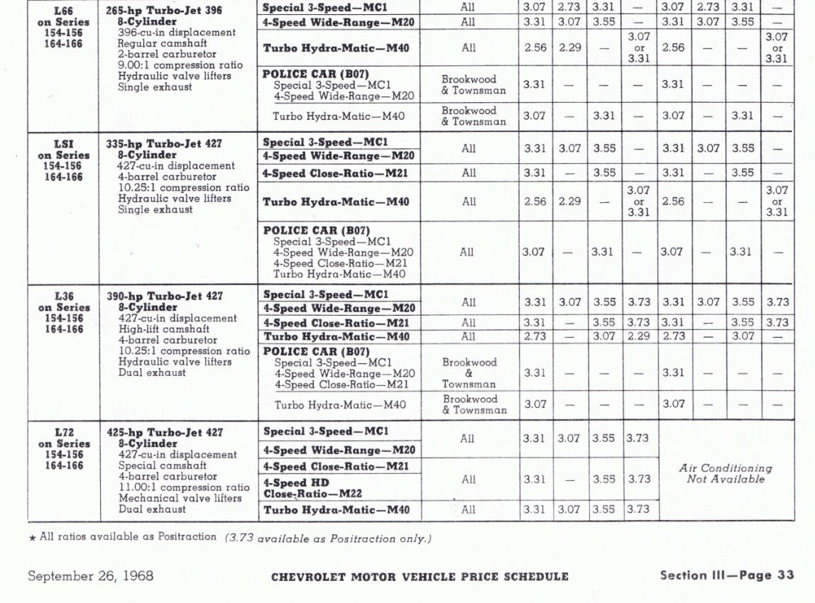

In 1968 you can get 4:10 4:56 and 4:88 as RPO
here is the 1968 Power Team Chart
you can see where the 1969 power team chart goes up to 3:73 but the 1968 power team chart goes up to 4:88

here is the 1965 chevelle power team chart for comparison
L-79 only goes up to 3:31 on the RPO
