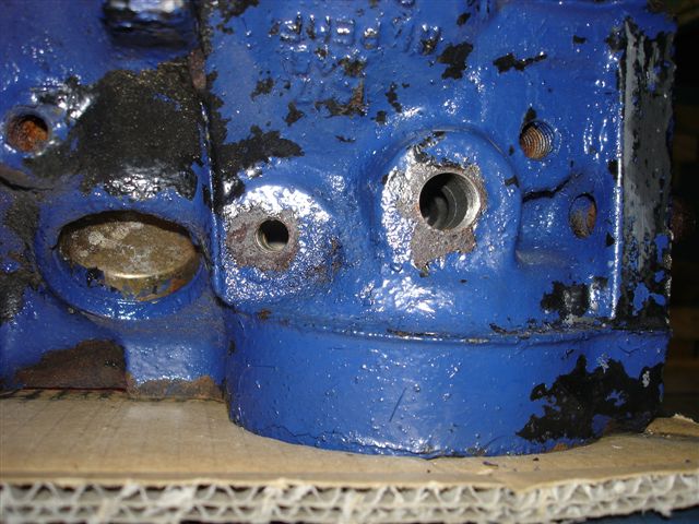

How do you explain the fact that I have two 4-bolt main blocks with the small "oil holes" ?
This pic is from my late -69 4-bolt #512 block.
Anders Stålklint.
