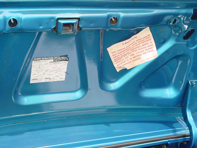

Over-restorers like to make them perfect, but I've never seen one that wasn't crooked.
like this? Donny Hood's awesome unrestored 69.

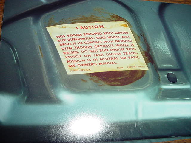

Here is a shot of one off of Bob Shellito's original owner low mileage LS-6. Talk about yuck!
Rick
