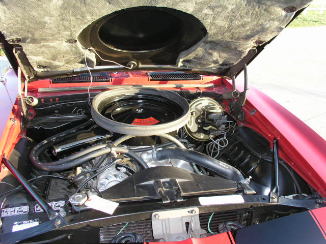

Default Re: How do you authenticate a 69 Z-28?
Here is my early Norwood Z with the vin on the pad.
