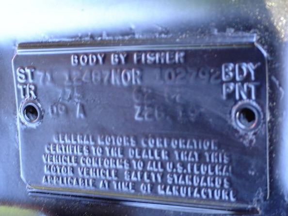

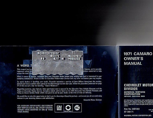

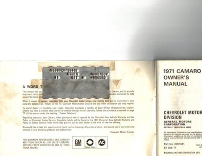

I am considering the purchase of a 1971 Z28 for my collection. Could you guys help me to ID and make sure the #'s match.
VIN: 12478N508832
Cowl Tag: ST 71 12487 NOR 102792 BDY
TR 775 62 62 PNT
09A Z28.19
I am posting pictures of the tags and PP. I will post the other numbers as soon as I receive from seller.
I appreciate any help.

"VIN: 12478N508832" <---- Are you sure that is typed correctly. POP looks different and is more like what should go with that car.

VIN should start with 124870N for Norwood cars and L for LA cars.
