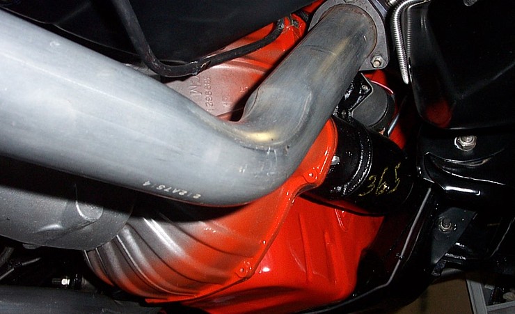

Old 03-29-2005, 04:46 AM
68l30's Avatar
68l30 68l30 is offline
Join Date: Sep 2000
Posts: 3,350
Thanks: 60
Thanked 92 Times in 44 Posts
Default Re: Bell housing color
Here's a shot of a restored hsg....I just copied what was there.....

Old 03-29-2005, 05:53 AM
Alss's Avatar
Alss Alss is offline
Join Date: Feb 2002
Location: The tax State of New Jersey
Posts: 2,542
Thanks: 19
Thanked 57 Times in 19 Posts
Thanks..just what I needed..I assume the bolts get painted as well? as if it were mounted on the block? thanks alot.

Old 03-29-2005, 06:08 AM
68l30's Avatar
Join Date: Sep 2000
Posts: 3,350
Thanks: 60
Yep,bolts and all.That's why the hsg was painted.It was in line of fire of the spray gun.

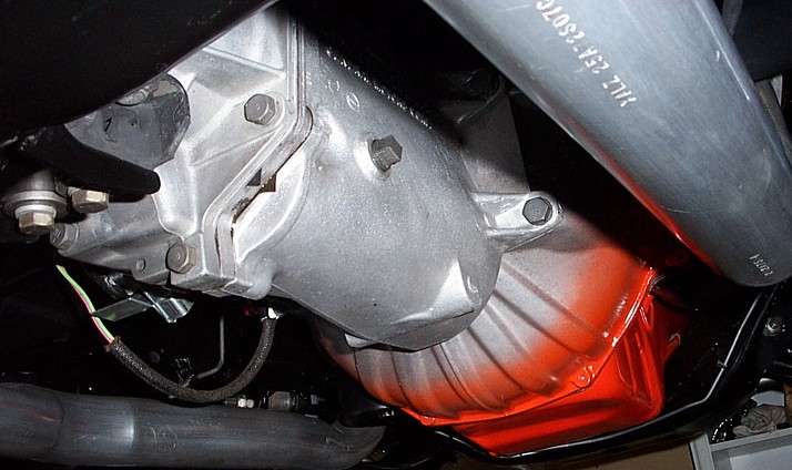

Old 03-31-2005, 07:46 AM
MYSTERYCHEVELLE MYSTERYCHEVELLE is offline
Join Date: Jun 2002
Location: Jeffersonville, PA
Posts: 1,106
Thanks: 263
Thanked 406 Times in 194 Posts
Well, as long as you are looking at examples...Albert this is my 66 SS....
Old 03-31-2005, 07:47 AM
Join Date: Jun 2002
Posts: 1,106
Thanks: 263
and
Old 03-31-2005, 07:49 AM
Join Date: Jun 2002
Posts: 1,106
Thanks: 263
another
