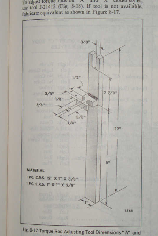

Can somebody please DETAIL, the "correct" safe way to R&R these springs......

Wear a helmet.

There is information in the Fisher Body Manaul. I do not have mine with me right now. It includes fabing a tool to make it easier/safer to remove the rods.
Here is the tool for the 70 Nova.
Greg

Frank Arone had a tool made to do this, I borrowed it and it worked like a charm. Otherwise, wear a helmet unless you have a helper to catch one of those flying rods
