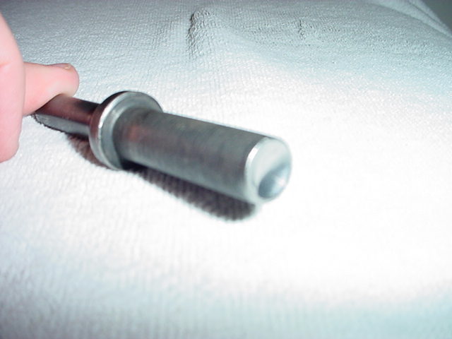

I dug through all my drawers and unfortunately I only came up with 5. I will have to see if I can get more of these. Several people have e-mailed me wondering what the tool looks like. This tool was made for me by a TC/sYc member and would be pretty simple to make. Hopefully the pictures are clear enough. On the business end, the is just a slight concave cutout.

picture #2
