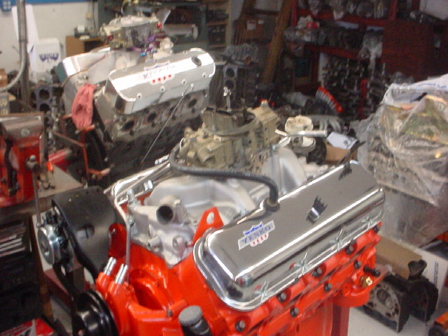

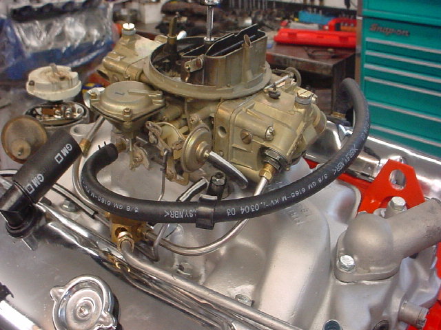

hey guys!
i've never run a holley 3 barrel before. I now have a stock 4346 on my 69 and was thinking of trying out a 4781 850. i've heard that the big 3 barrels never ran that good but have never tried one myself. i've seen 950's and 1050's
for sale on ebay. do you think one would out perform an 850 due to the size? maybe pete has tried one.
i am putting the motor back in my car after a few mods and have been thinking at nite about this... i need more MPH!!!
let me know what you think.
thanks! steve keech sarasota florida
