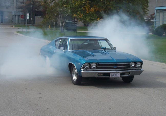

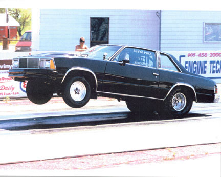

I run vac u pan on my ZL1 motor and it seems fine but you can also run a puke can with a breather on top fastened to your rad support plumbed to the valve cover, I've used 2 of these cans on a buds BBC pro street/strip chevelle that made a mess of oil on the valve covers and that cured the problem, but he drives like this ( see pics )

straight is good but how about hoping this car goes straight. 1.28 short time in the 60 ft and 9.50 @ 140 mph on the motor in gramas car. [img]/ubbthreads/images/graemlins/[/img]
