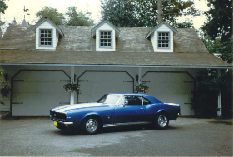

Howdy, we have built two new homes and have tried to improve on the garages both times, here is what I would have if I had more room and it sounds like you have a nice lot to work with,
8íX18í Garage doors
Deep enough to build a bench along the back wall, A Reeeaaaly long one, mine is big and I cannot believe how stuff accumulates on it, and have to fight at times to make a small work area.
Roof trusses Special design so you can store stuff in the attic. I did it on the last one and it has saved me big time, keeping stuff off the floor and upstairs, A nice lift to the attic would be nice, I saw one recently, a fella took a lift gate off a delivery truck and stuck it along a wall, very neat and looked pretty easy to do, sure would be nice for motors and tranny's, I cant seam to getíem up my ladder, lol
One bay for sure with a lift,
Put fake dormers on the building so it looks nice with your home and not a big barn
Seal the floor.
Overhead gas heat with enough BTUís to get it at least 80deg in there for painting.
Sprinkle the building, meaning overhead Fire sprinklers, just in case, plus it lowers the INS rate.
One stall for a paint booth if you have enough room.
One room sealed from the garage with the grinder, torches, sand blaster, etc, keeps the mess to one area.
And an office with a restroom is a must.
Cable TV for those easy weekends in the shop, I donít think I could work without mine.
Oh and the customary old Beer fridge covered in stickers, set at a perfect 33.5 deg, That one has saved allot of guys from expiring on the spot.
I am sure there is more but I am a simple guy and donít need much, lol.
P.S. The old saying about a happy wife and all is ok, well it works both ways, She can do pretty much what she wants to the home and you get a decent shop, worked for me, well sorta.
Good Luck, Bud. [img]/ubbthreads/images/graemlins/beers.gif[/img]

I miss that car something terrible, I think about it all the time, I sold it back in 88' to pay for school. I dont know how to exsplain it, You ever walk through a show and a car stops you in your tracks with the paint job? not the color but just the way it looks, That car would do that not that it was any better than some of the other cars, I still run into cars that do that to me, granted all the cars are arrow straight and the body lines are perfect, some of them just do that to guy??? One of those mysterys in life.
Post some pics of your car will ya! its been killing me to see it.
Bud.

Thanks Bud and others for the comments so far. Bud, nice garage! I like the car too (I hate to admit it on this site, but I much prefer '67 Camaros over '69's personally - I guess that explains why I've owned 27 '67's and only one '69 [img]/ubbthreads/images/graemlins/laugh.gif[/img] ). I'll be at the land later this week and will take a pic or two to show the overall area. Most houses have three car attached garages, but I am thinking of doing two double garages joined in an L-shape with a big work area between the two garages. I saw this set-up when I went to see a '67 RS/SS that was for sale in Idaho a few years ago. As for heat, we're doing radiant floor heating [img]/ubbthreads/images/graemlins/cool.gif[/img]
