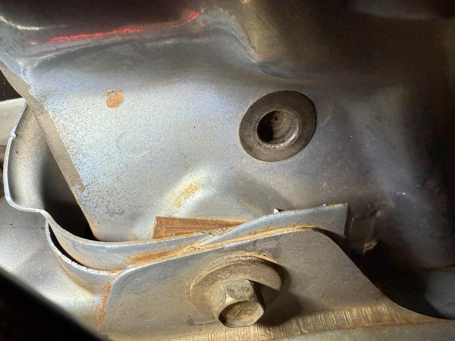

I have conflicting information about this. Does anyone have a Norwood survivor car they can check to see if the front fender shims at the A Pillar are plated silver zinc/CAD or black manganese?

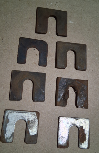

survivor 69 shims
The Following 6 Users Say Thank You to Charley Lillard For This Useful Post:
169indy (10-13-2025), dykstra (10-16-2025), JJR69COPO (10-12-2025), L78_Nova (10-16-2025), RPOLS3 (10-19-2025), SS427 (10-16-2025)

sure look like phosphate or bare steel - i would think these are phosphate

From the many original cars I've observed during Vintage Certification as well as having my own car through Legends Concours judging in 2024, the A pillar shims should be black (manganese) phosphate.
