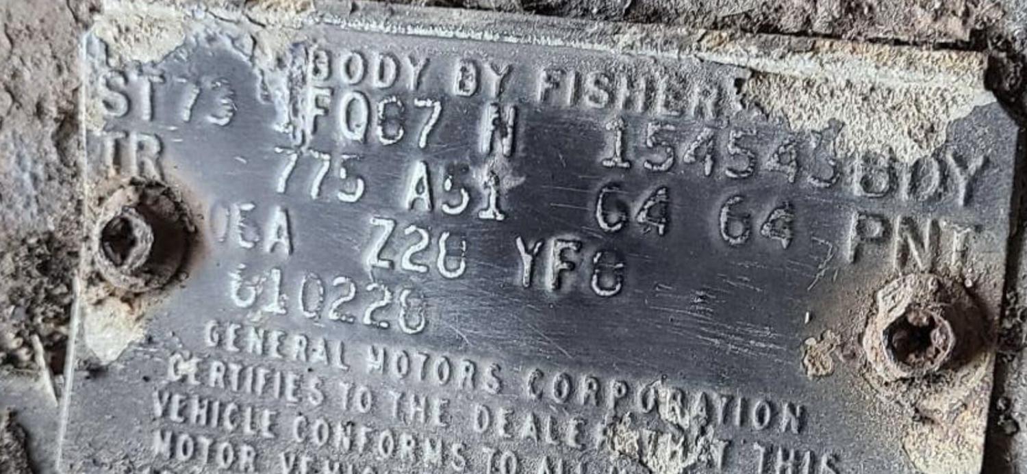

Default '73 #s Z/28, $8000 Project
Seems like a decent deal for a Z with its original block included.

Silver with black interior

the data plate has been removed, those are not stock rivets...

I'm no expert on Camaros, but I thought the screws were correct for a 1973?

Should be.

This is close to the end of rivets,3rd week of April. GM used those screws after.

That is the correct looking screw that they did use. Same ones on my November '74 Z.

well, just got educated on Chevy data plate rivets...
