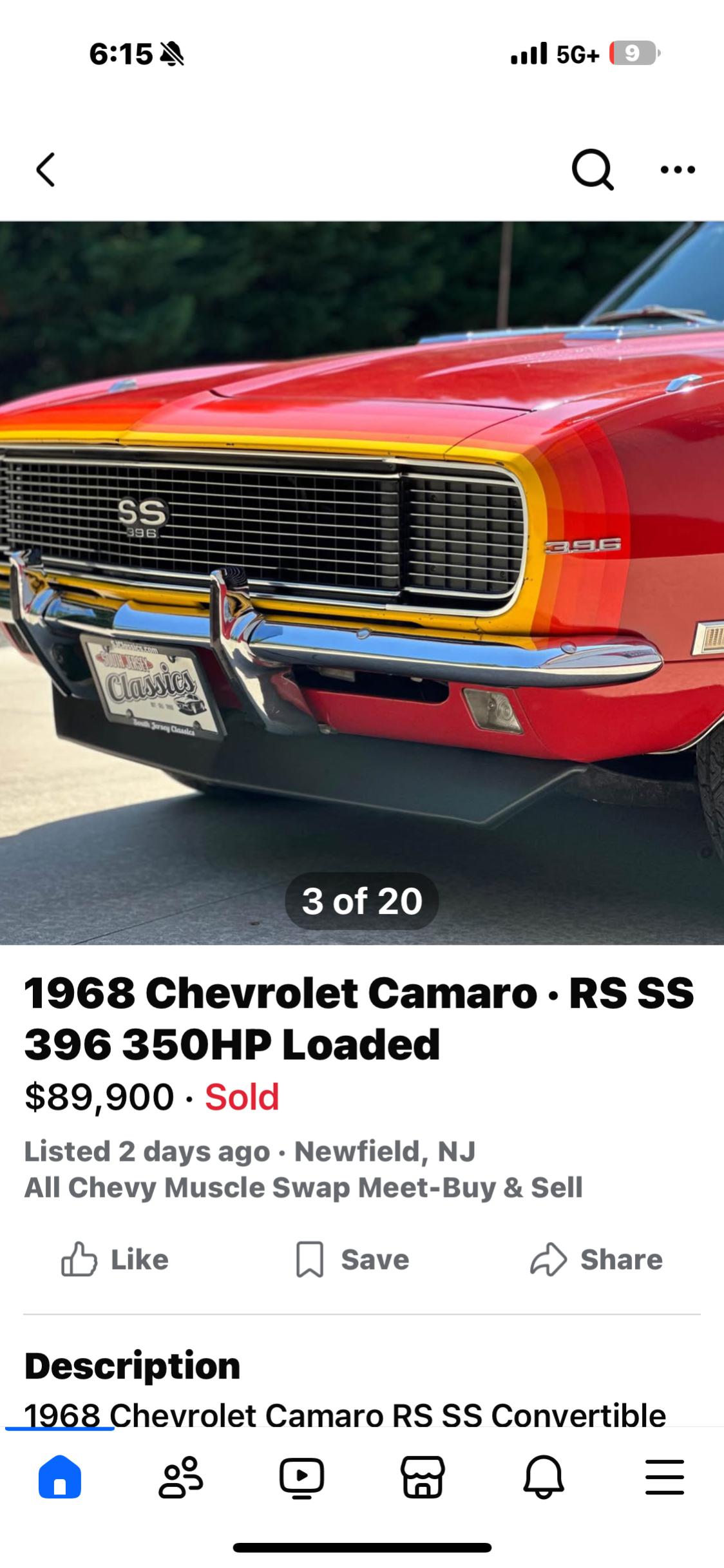

Default D88 stripe ??
Never saw this car before. I know there are pics of early promo cars back in the day, but Is this car original with this stripe? Are there other known examples?

According to CRG it was cancelled. None were ordered....Joe

That's pretty cool looking. Imagine if it would have been a short lived option, it'd be haled far and wide, and documented examples would command a super duper premium.

Looks to me like it's painted on.

Looks like a highly optioned Camaro with fiber optics.

A friend of mine (yes I have friend) saw this car in person. The striping was added, amongst a few other options. But the nose stripe never got into production and was a vinyl application IIRC.

The car has issues - it's been around like this for 25+ years. Fake trim tag, SB AC box, 69 belt setup, restamped block, etc.
124678N409488
