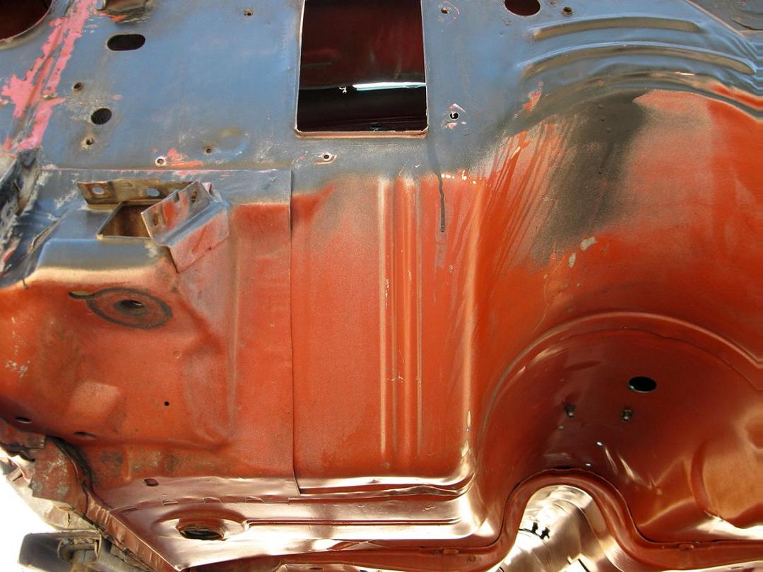

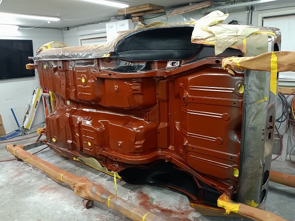

Old 02-08-2025, 01:36 AM
Posts: 2,714
Thanks: 130
Thanked 297 Times in 104 Posts
Top pics are Original Firewall Black out
Lower is picture of my Z28 Firewall
Some of us are using SPI (Southern Polyurethane) Red Oxide (blended with Black) to acheive the correct 70 Norwood "red oxide"
