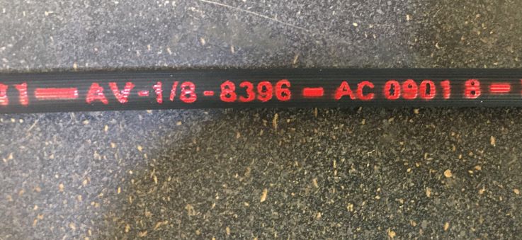

does anybody have nos 69 z28 front brake hoses or does anybody knows who makes the correct hoses.

Wagner & Bendix products both make correct hoses.
Old 11-27-2019, 03:44 PM
firstgenaddict's Avatar
Posts: 5,596
Thanks: 161
There are no hoses reproduced or manufactured which look like an original.
DOT regulations require double crimps VS single crimps as the originals had.
I had a set of hoses dated mid 70's which were single crimp however I do not believe they were produced much after that time frame.
Last NOS front disc brake hoses for a 69 F body I saw went for nearly a grand.
~JAG~
NCRS#65120
NUMEROUS Lemans blue Camaros,
& a Chevelle or two...

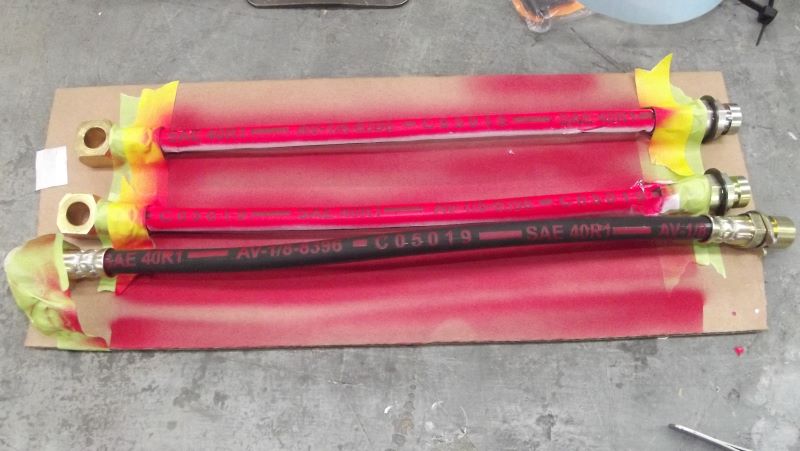

Here is my first attempt at stenciling the rear brake hose on my '68 Camaro. Not perfect and I think there's room for improvement but it's a start!

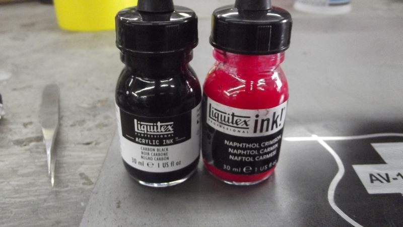

I had issues doing this using paint before and on Grady's Red COPO I switched to a acrylic ink, worked great, took several light coats applied with a Badger airbrush. Used the same ink for the tank stencil, tape pulled off clean.
Reviving this thread for a question.
What type of stencil tape did you use, Mike? I have a vinyl sign cutter machine available and want to try this. I tried having a custom stamp made and couldn't get enough color saturation. I have an airbrush and would like to try with a stencil.
thanks for any help anyone can provide.
Dave

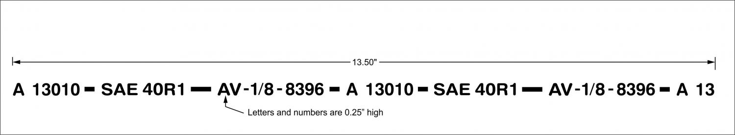

Reviving this thread again, does anyone have a lead for sourcing the stencils that Mike posted photos of above?
