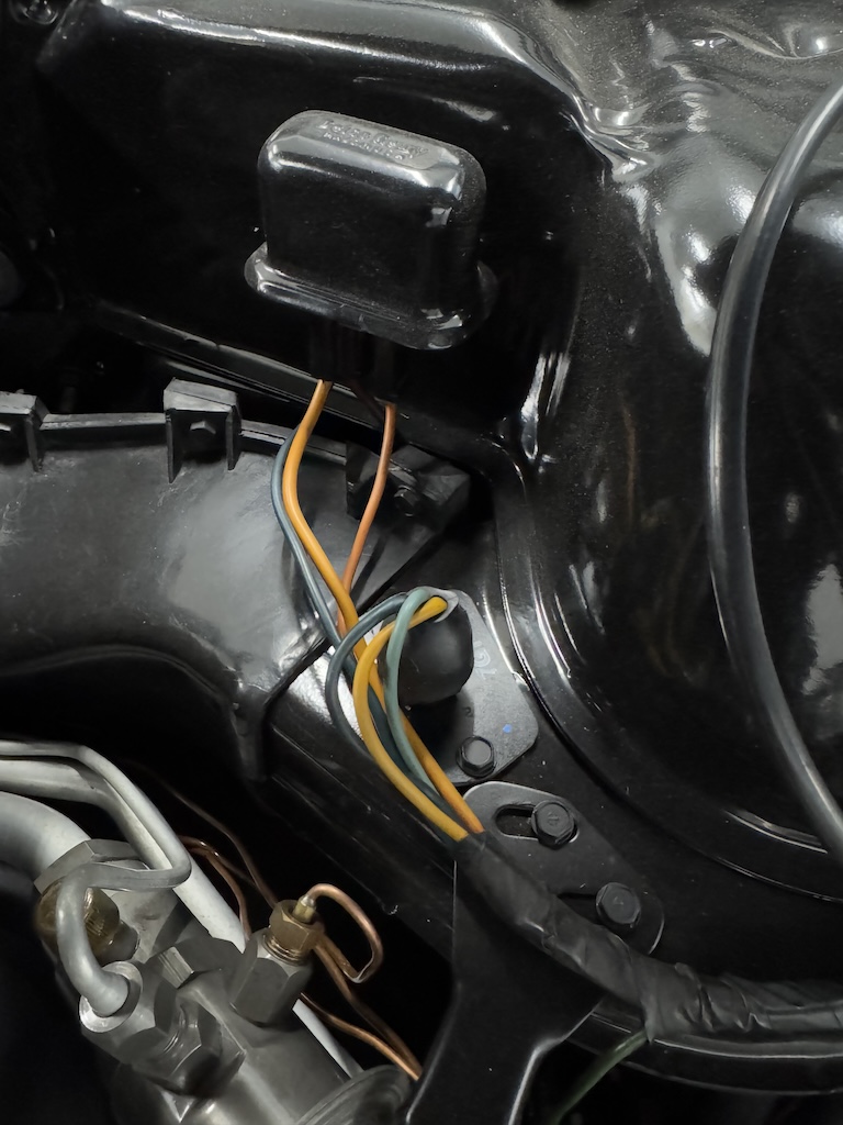

As title says. Low speed works. Hi works. 2 and 3 make no change to blower speed.

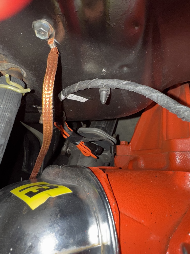

There is an orange wire running through the firewall gutter that has been cut and folded back into the gutter.
My first guess is that I need a new rheostat. Anyone deal with this recently?

Yep, fan speed rheostat has failed. Non A/C are easy to change, right on top of the core housing inside the car. No recollection of where they hid it on the A/C housing.

The a/c rheostat is easy, right up on top. That orange wire in the engine harness powers the blower motor on non-a/c cars, it is typically coiled up and taped to the harness unused.

I thought I remembered reading something about that in the AIM (also for 69 Camaro with C60). But, I didn't want to ask because it sounded so dumb. Can't believe they didn't just use a different wire harness for AC.
Pretty sure the rheostat is right on top of the suitcase.
