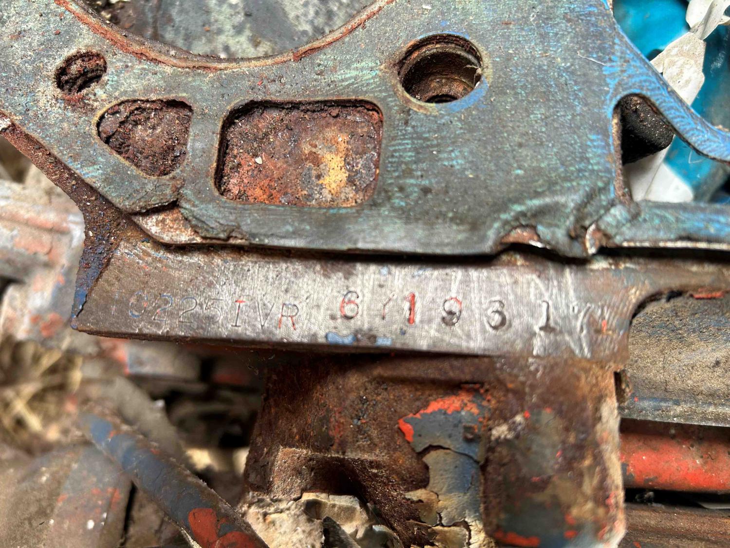

The one pic of engine parts shows 1968 or later heads with temp sender holes. Based on that, the sort of ad it is with no useful pictures, and the disappearance when Steve asked for trim tag and codes, I give it about a 0.00001% chance of being an L78.

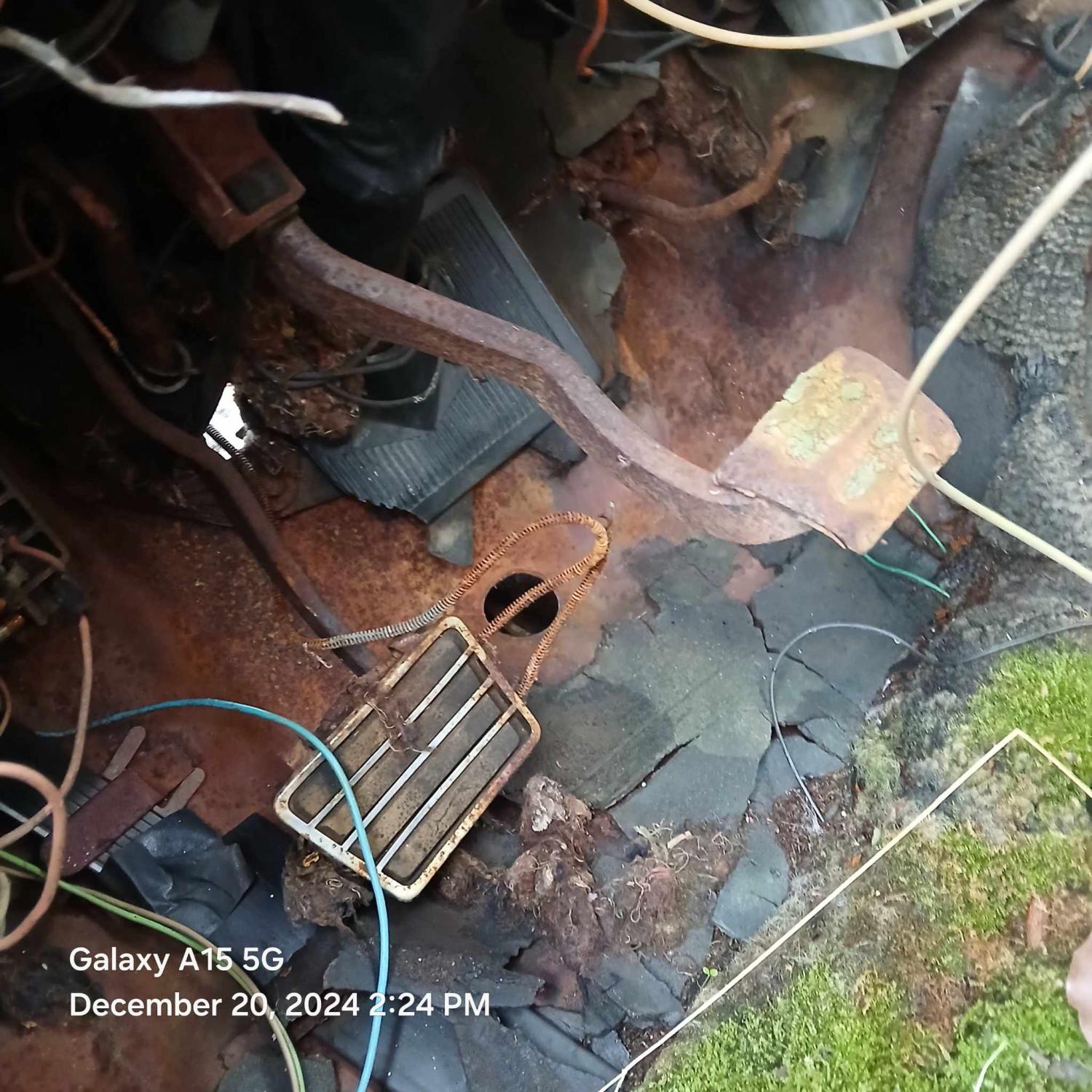

Heard from seller this evening and I'm going to check out the Chevelle tomorrow morning. He sent me some additional pics...has three pedals, but was converted to automatic. Engine pad should be real easy to see. I'm looking for an EG code stamp, correct?

Trim Tag date of 09D (late September 66) precludes it being an L78, since they weren't available until late spring of 67. That thing looks awfully rough.
