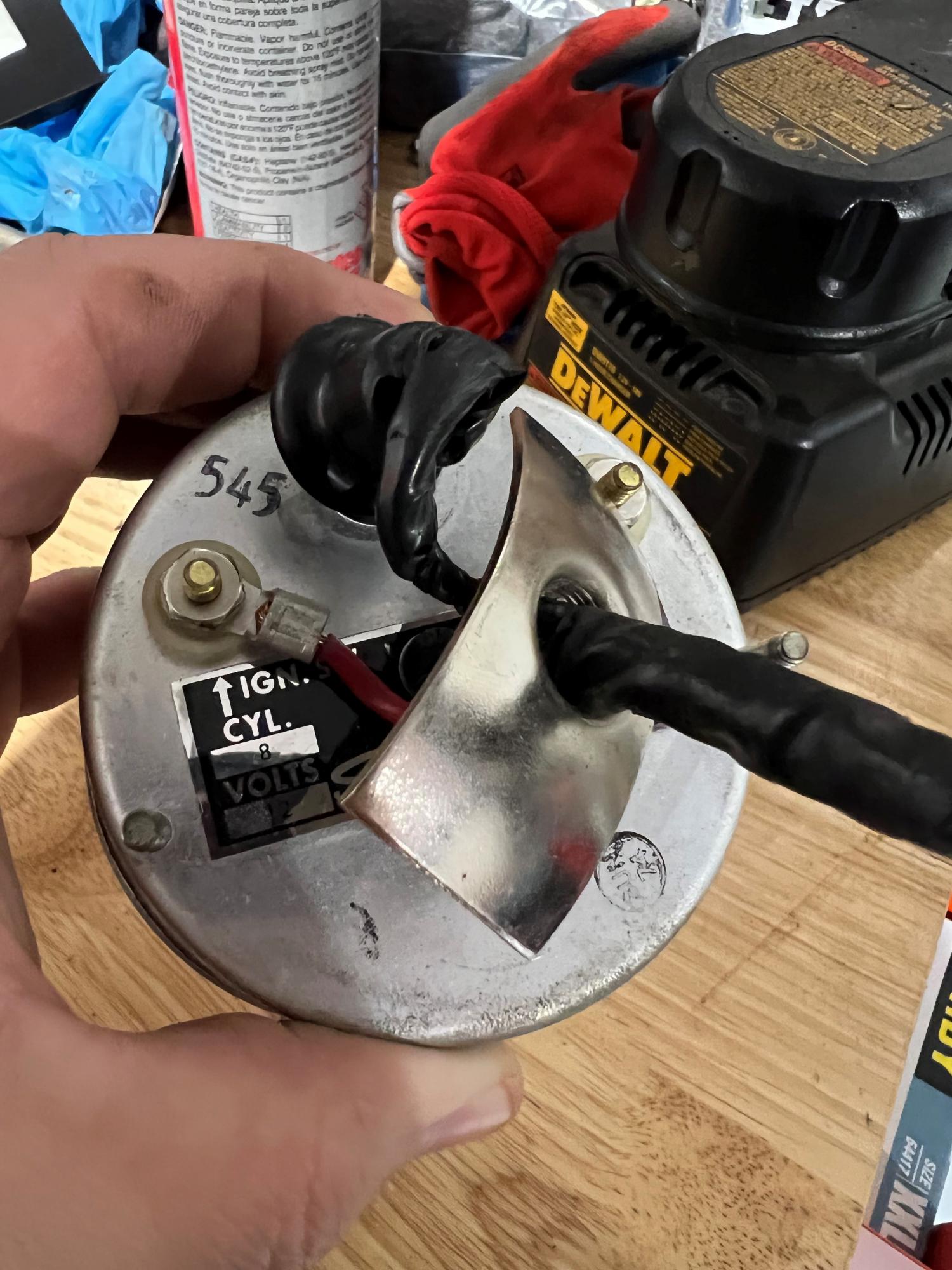

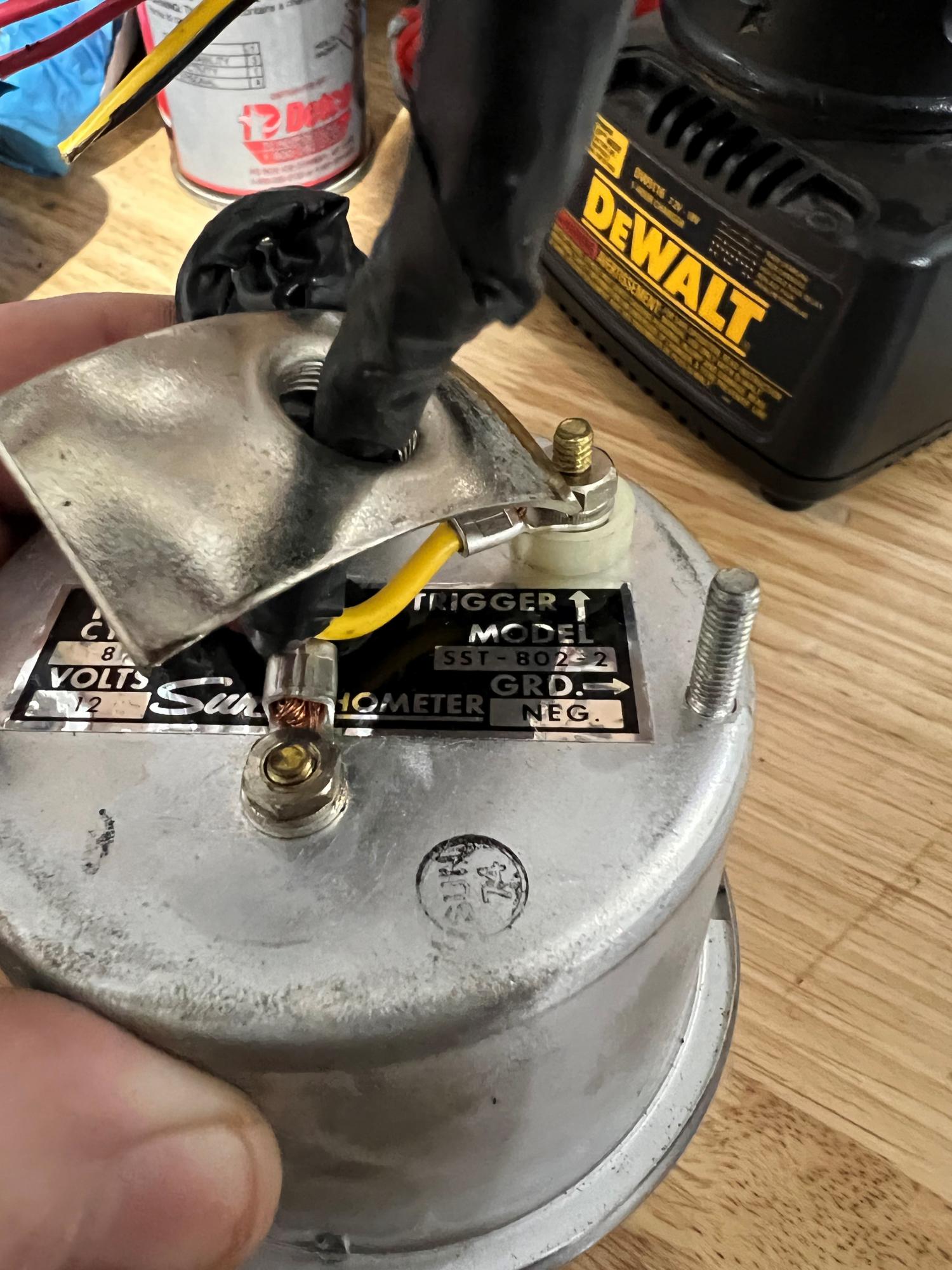

After removing the chrome cup, I have an SST-802-2 for an 8 cylinder engine and it has a stamp in black that says 545 close to the light socket. Is this a date code?

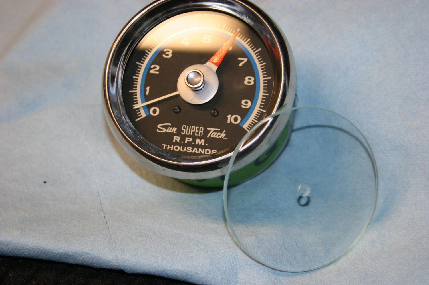

2. Anyone here ever replace the glass and how easy or hard was it to do?

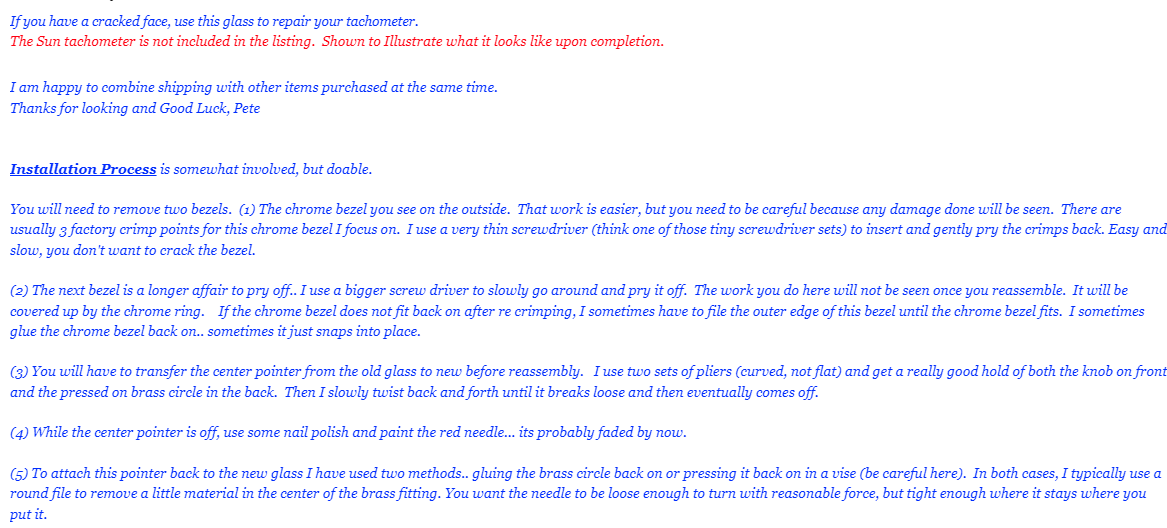

Been looking for info on this as well. The seller that has the replacement glass, shown in pic, actually has a writeup describing how to replace the glass. Not sure if I want to tackle this or farm it out.

The glass can be replaced but I don't think it's easy to do. If you're on Facebook, join the Sun Tach group as the folks on there can answer all of your questions and more.
