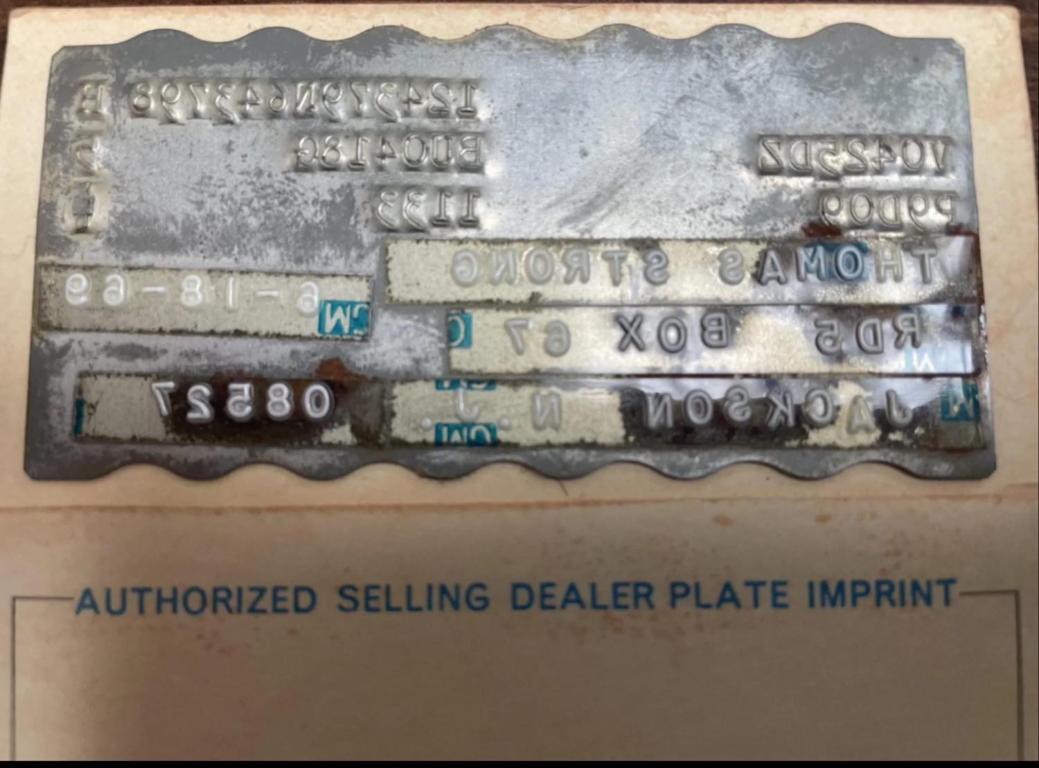

Here’s the POP.

Mecum ad states period correct block. If its not the factory one they got lucky and found one to match the POP
Hard to imagine it is not the factory one
