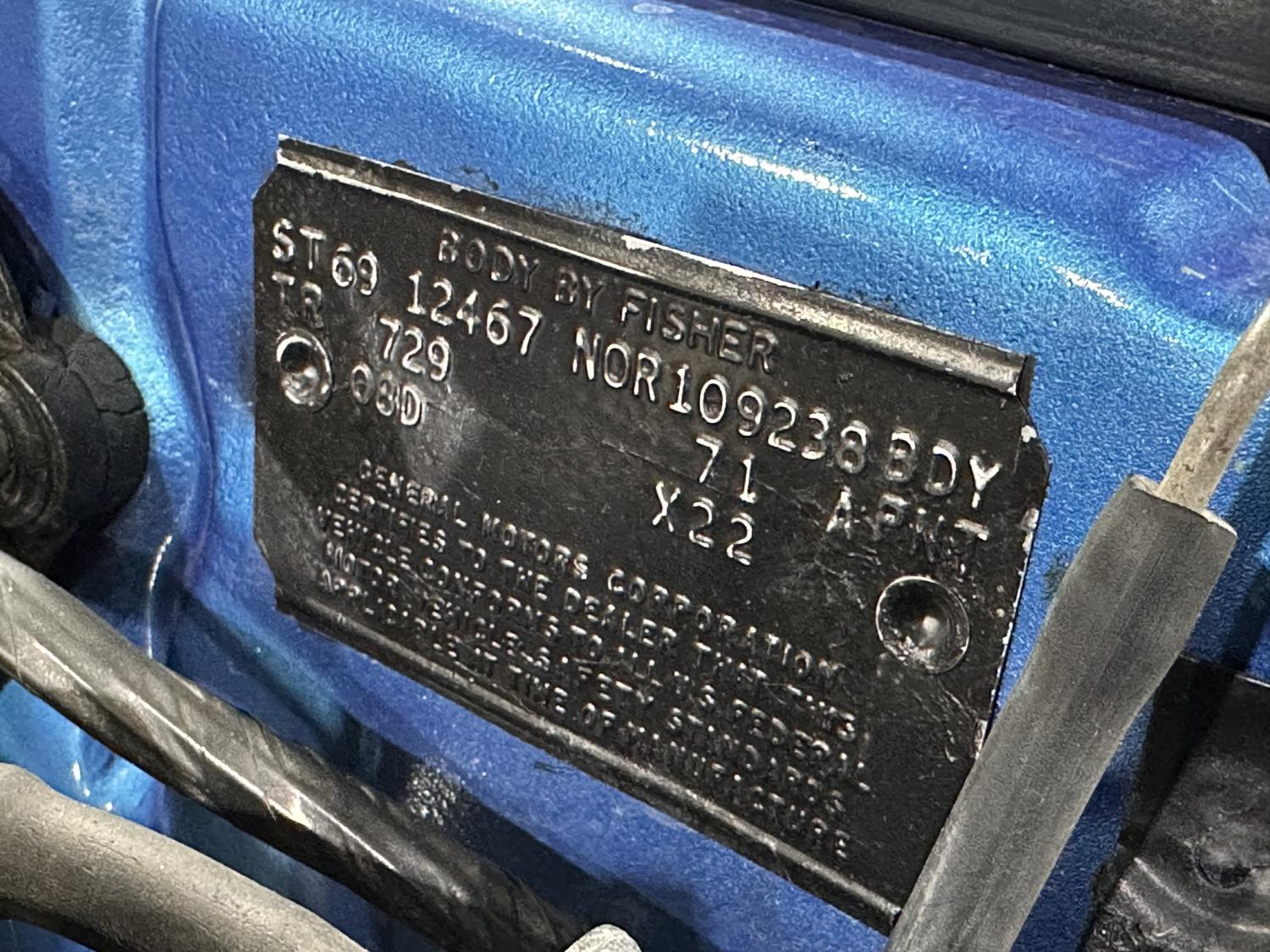

Not counting pace cars. Could you get a houndstooth interior in a 69 Camaro vert? I didn't think you could. This tag shows it? Fake tag? Any feedback is appreciated. Thxs

Like you, I thought the only deluxe int were in pace cars

Fake tag.

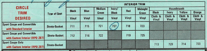

No convert houndstooth interior other than Z11. From the 12-68 rev of the dealer order form.
Worthy of note, earliest known 714 interior is mid-February. Earliest known coupe 720 interior is mid-April.
Only produced about 600 714 cars, 500 720 coupes. I owned two 720 Z/28s, one JL-8.

Yep reproduction tag
