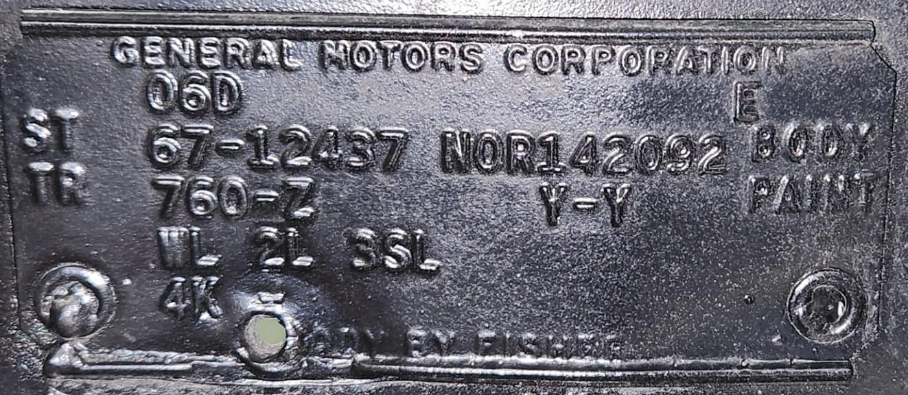

I have never seen a trim tag on a 67 Camaro like this Norwood built car. 4k- no color code any ideas on what that means? TY!!

It looks like th 4K was added.

Never …. ever saw one. But I’m not an expert

The 4 is too far to the left.

See the dfference

I’m sure others with much more knowledge will chime in. But, I’ve recently read that it means “stripe change”. Potentially color change or deletion, etc., but that the stripe around the nose was changed. Hope this helps and hopefully someone with solid information posts.

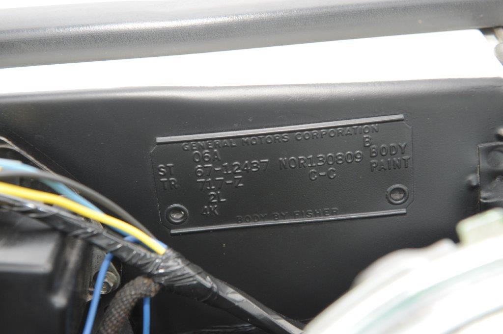

Default Another example
Here’s another example:

Mine
Richard
1967 Camaro SS 396/375 4K
I see what you're saying there. I am no camaro expert at all lol. I thought it looked odd as well.

The whole tag looks inconsistent with the depth of the characters. The 4k loos crooked and not properly positioned.
