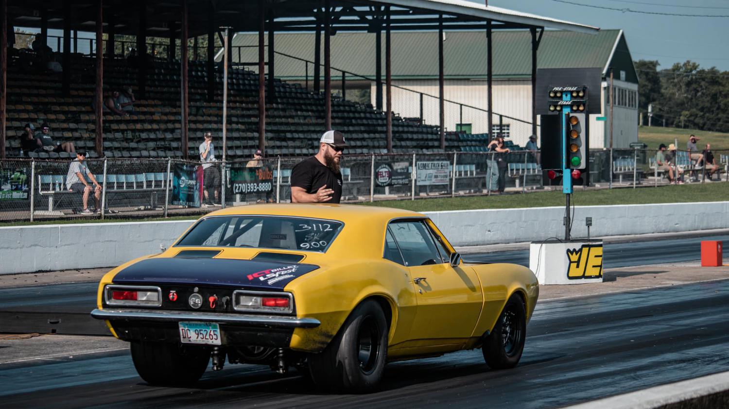

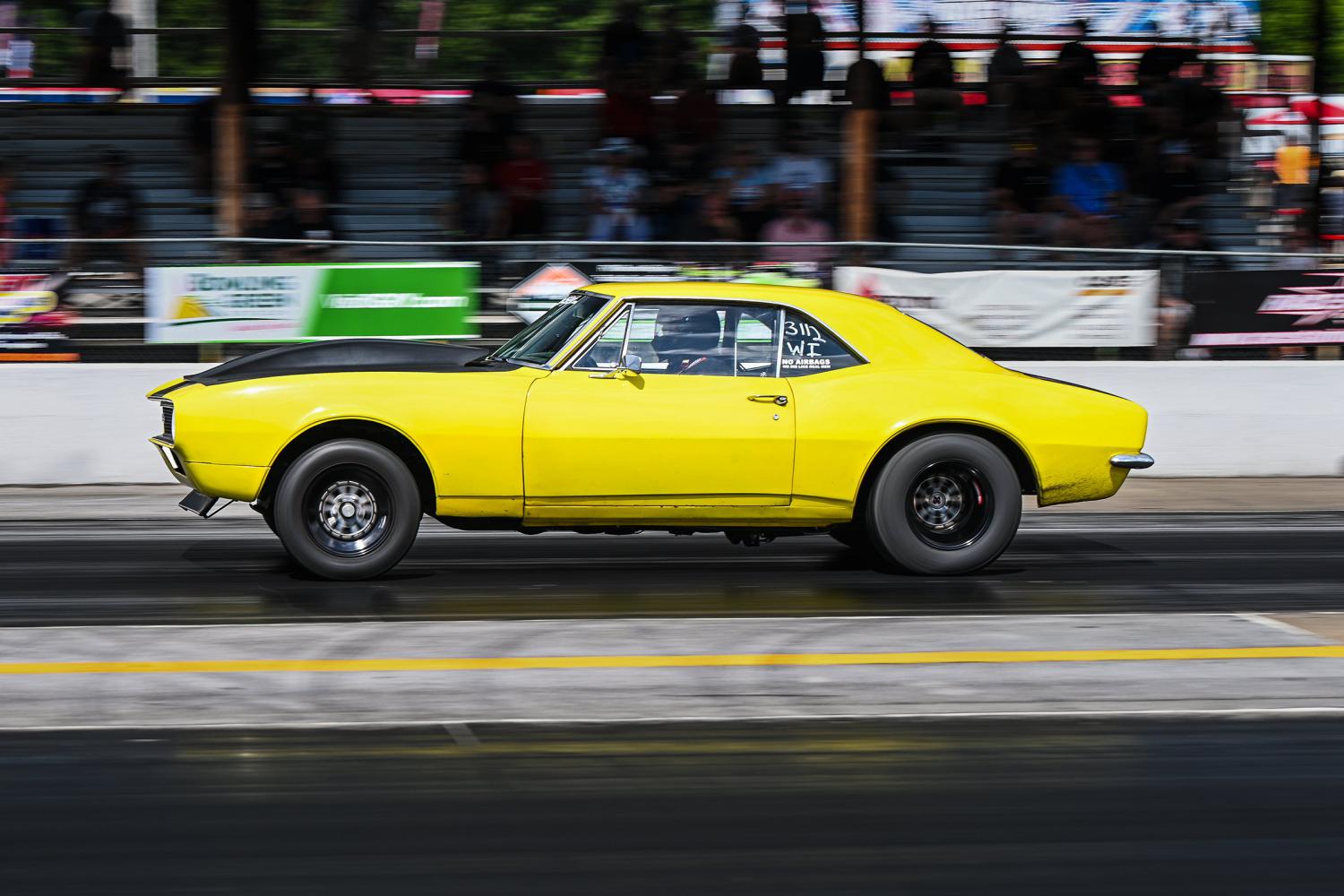

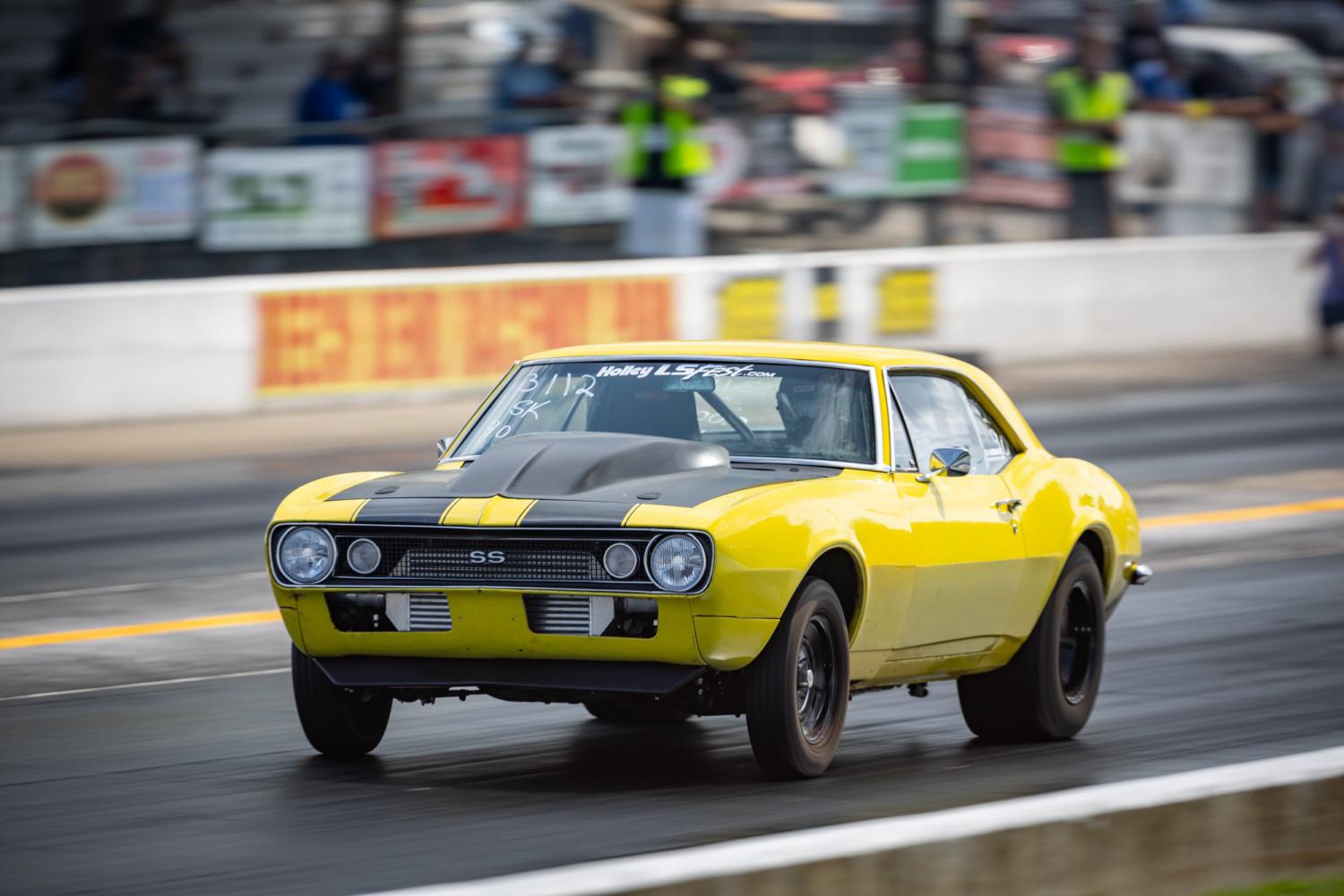

So I've got an old hacked up '67 Camaro, was tubbed probably in the 80s and got a narrowed rear end around that time.
I re purposed the car as drag and drive car.
LS 5.3
85mm turbo
T400
9" spool
3225 raceweight
I made 6 passes last weekend. Best of 6.04@123 in the 1/8th and 9.3@149.
Has a higher speed handling issue, wobbles.
Anyone running factory rear steering, factory box who has swapped on a TRZ bump steer kit?

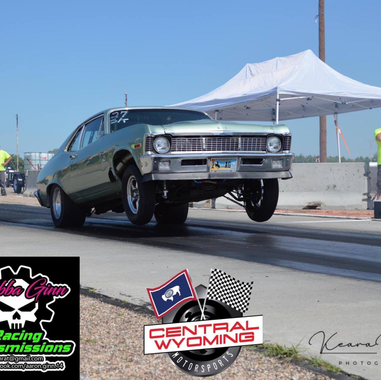

I'm planning set up mine like my friend Aarons, check out the spacers below the tie rods:

Can't comment on the TRZ kit but I will verbalize an observation of mine ... your rear coil overs look awfully close together compared to where the tires sit. Spacing them out could only benefit you and, if you don't already have one, a rear sway bar might be a nice addition.

Yeah those being close together probably is not helping. I'm monitoring whether I need to add an ARB, playing it by ear.
