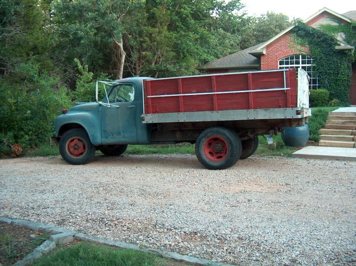

I really love my 49 Studebaker dump truck. Every time we think about selling it, we find another reason to keep it. Very versatile. The bed sides come off making it a flat bed. The dump bed still works, so hauling crap to the dump is a breeze. I converted from PTO operation to electric over hydraulic. I don’t remember how much of the story I have told here. Originally a flathead six with 92 HP... when it was new. Probably down to 70 hp when I got it. Anyway, once the head cracked, I could not bring myself to spend any time or money on such a weak power plant. So, bought an engine, transmission and drive shaft from a 72 Chevy dump truck. Truck bell housing and 13 inch clutch. Went from a 4 speed with NO synchros (that’s right, from the factory NO synchros) which meant double clutching for every shift to a five speed with mostly worn out synchros. I did well upshifting. Downshifting... no so much. Fab work was a challenge, especially getting the clutch linkage set up to us with the stock pedal. Had to use a bell crank to reverse the direction.

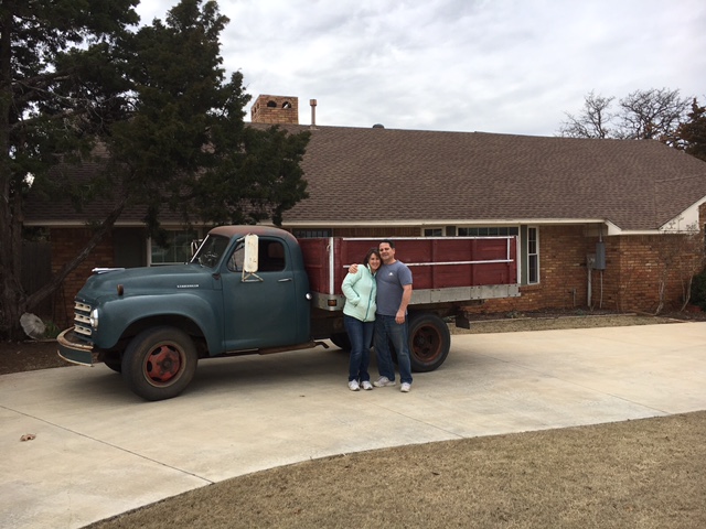

BTW, it has been a few years since this photo was taken. I am older now, but about 3 pounds lighter. So, as Carl (from Caddyshack) would say: "I got that goin for me."
