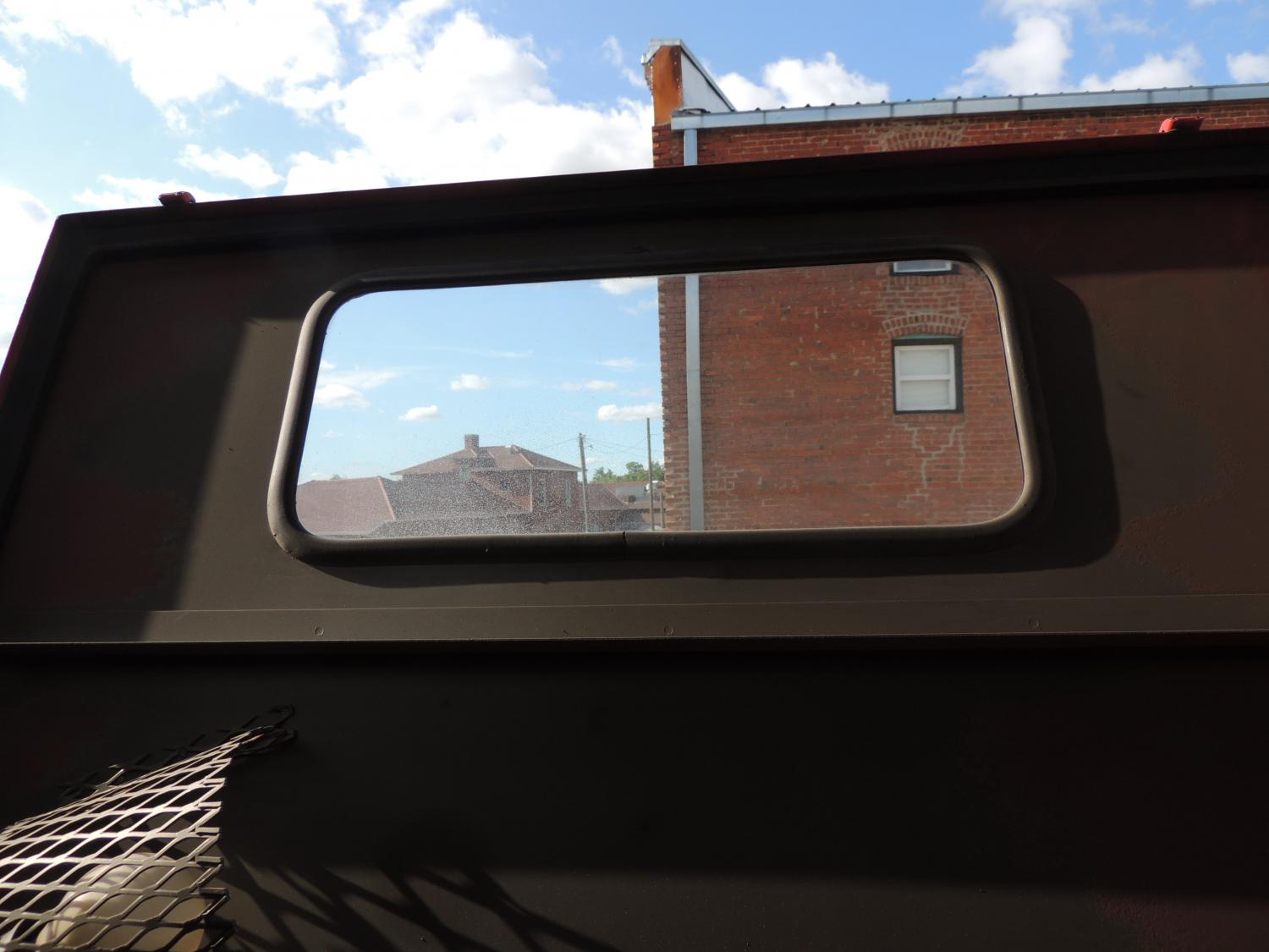

Same with this blast cabinet. Shudder to think what the original owner paid. I paid $100 at the going out of business auction. I don't think anyone else even realized it was a SnapOn. Well built. Had no idea what worked or didn't, but figured the bare cabinet was worth that. Turns out the light (although a bit dim) and the exhaust fan both work. Even the glass is in decent shape. It was so dirty, that I had thought I would be replacing it. But cleaned up pretty well.

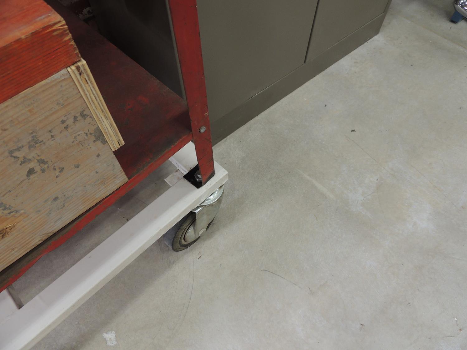

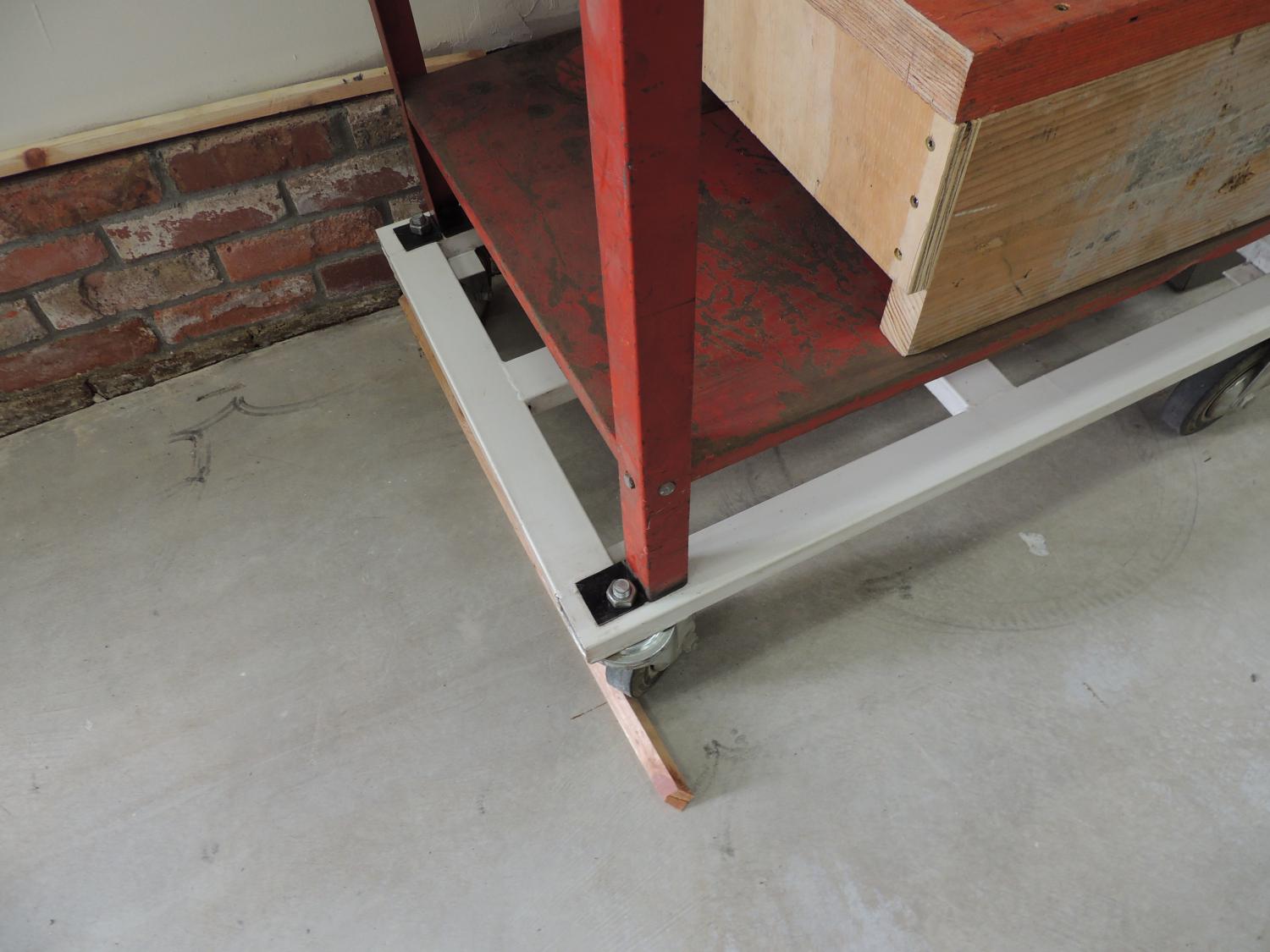

Other than being dirtier than a New Orleans hooker, there really isn't much wrong. I did replace the gloves, which took about 10 minutes. What took a lot longer was adapting it to this white base so I could roll it around.
I made sure to install compressed air fittings just outside the big doors on my shop, so I could blow off really dirty stuff outside (with the doors shut) to keep from getting more dirt in my shop than I already have. Also have switched outdoor outlets.
This white base was part of a giant drying rack I picked up for 10 bucks at another auction (and that wasn't even the best deal I got that day). It was very close to a perfect fit for the blast cabinet. I welded on little feet, drilled holes in them and ran the 5/8 studs for the casters through the feet. As you can see, I had to offset them on one end.
Of course with these giant casters, it now sits 9 inches higher. So, I made a little step stool out of scrap lumber. I don't throw much wood away... it has to be really small scraps before it hits the trash can. Plan to put an anti fatigue mat of some sort on it. Yeah, Lynn that'll do it. A little foam rubber and no more fatigue. Keep telling yourself that. Well, probably won't hurt.
