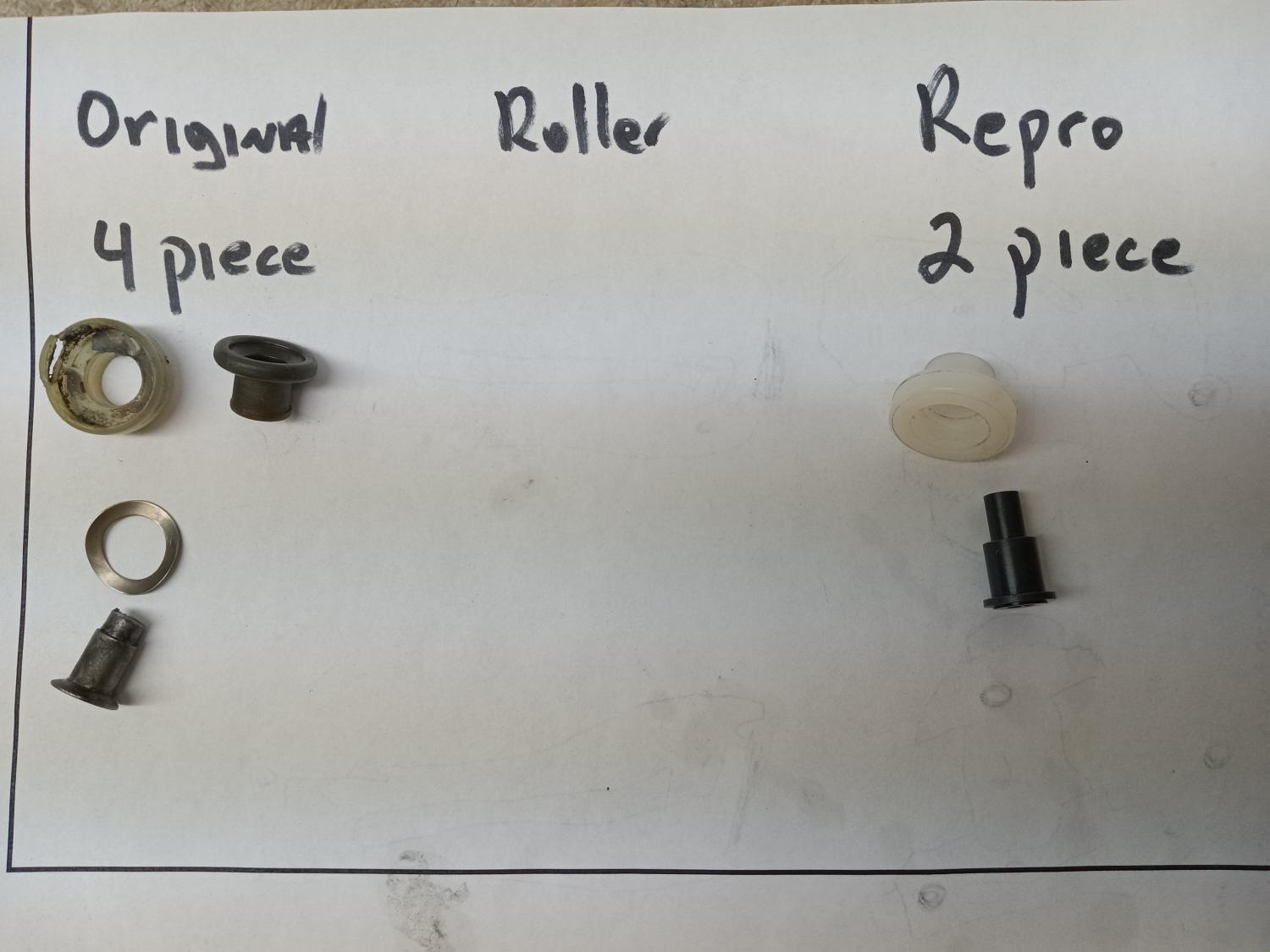

I have searched every possible vendor for the front door window regulator rollers. It seems like they all offer the same design roller. My picture shows how different the original roller is compared to the repro. The original design has four pieces and the repro has two pieces. Has anyone used the repro roller with success.

Can anyone help me with the installation of the repro window regulator roller. Is it as simple as just peening over the other side of the rivet.

Hello, yes thats what I did is peen over the stud. Kind of an x pattern but be careful not to go too far. The window rolls up and down but only time will tell if the fix holds up.
