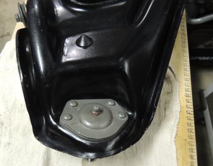

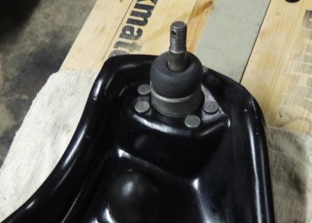

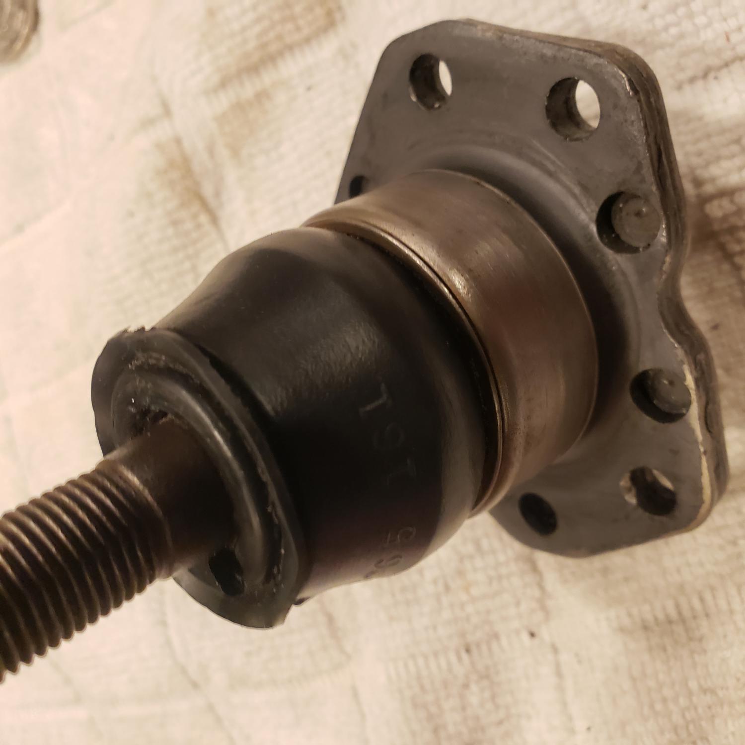

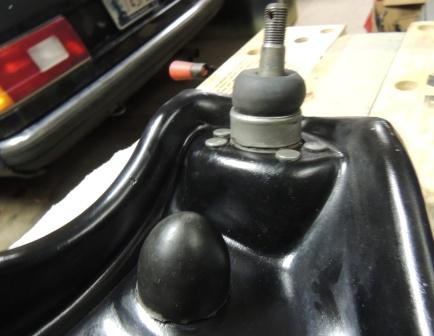

is it possible to replace just the boot on a upper ball joint on a 69 camaro if so who sell the correct replacements thanks

Yes. The Corvette vendors have one that works very well.
JMHO, but the upper ball joints seldom wear out on first gen Camaros. Lowers are good for about 40k miles.
Replacing just the boot is a great way to do it so that you don't have mess with making the rivets look correct.
Here are mine. Probably "over restored".

It has been 12 years. I don't remember removing a ring. IIRC (BIG if) I just peeled the old one out, cleaned all the grease out, and installed the boot, tucking the lip up into that retainer.

I dissagree that the original boot can be removed and new/replacement boot
install WITHOUT removing the ring.........I carefully pryed slowly, repeatedly, round and round on bottom edge of ring to pry it up and off the ball joint.......and still had to deburr it abit before reinstalling .....Also used a small diameter flapper wheel to polish ID of Retaining Ring....
