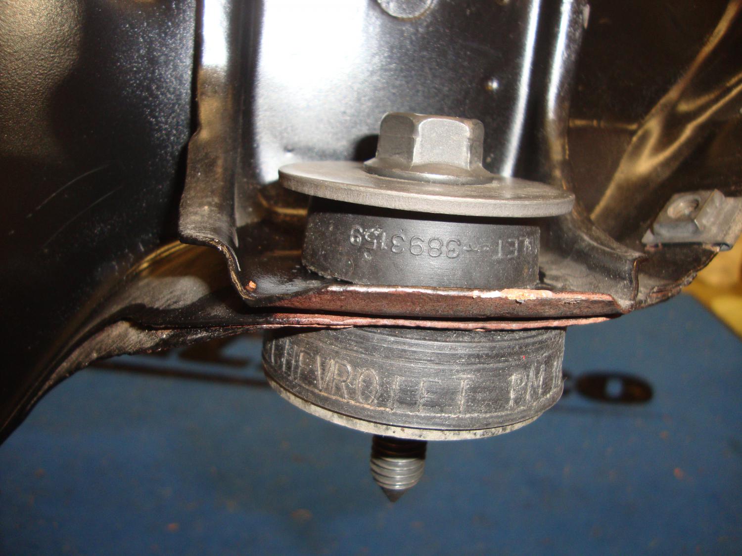

Default 1968 Swap import Bushings for NORS GM parts
Done
Mine No Motor,
One side at a time, Front end loose A partial Project car.
Loosening Fuel and brake lines clips/retainers.
Jack body at rocker to gain separation distance.
69 Los Z11
68 SS/RS 396/325
68 Los Z28
