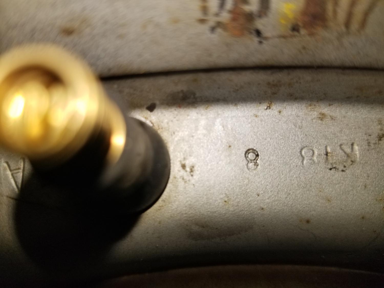

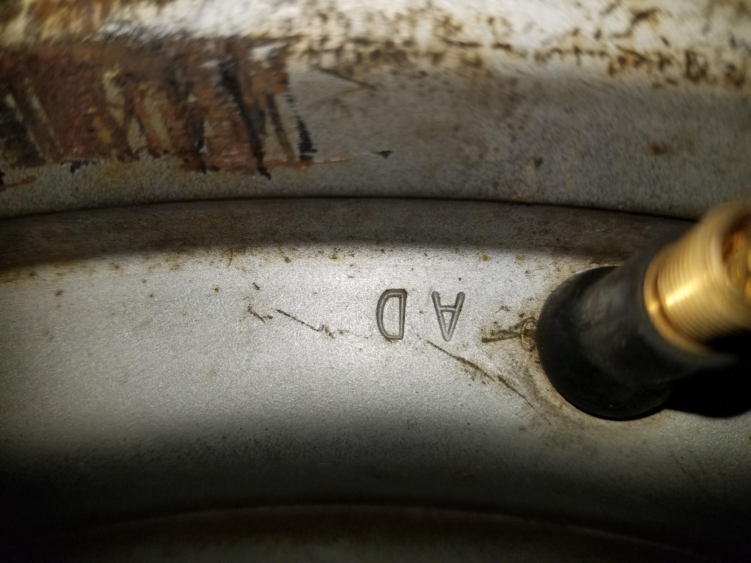

I am looking at an "AD" rally wheel that is date August 1968. Did this wheel come on anything other than the early 1969 Z28s? Thanks.

Nope, early 69 Camaro only.
I've found lots of 69 YH's over the years, but only 1 AD.

Our Z is 4th week October 68. We have a set of 5 dated the same day 68 - AD. Very hard to come by and very expensive…

I have one dated 10 24 AD if someone is looking.
