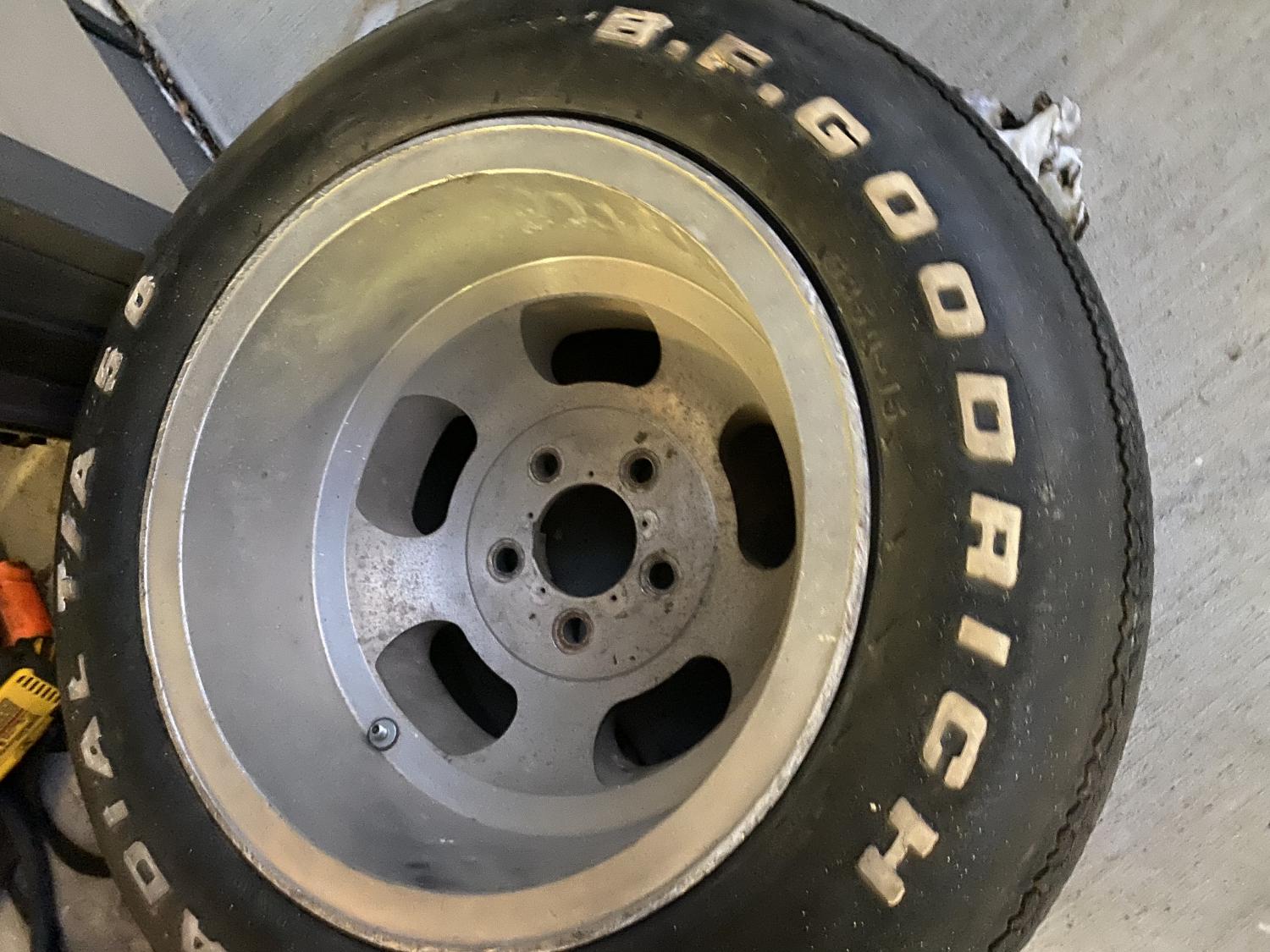

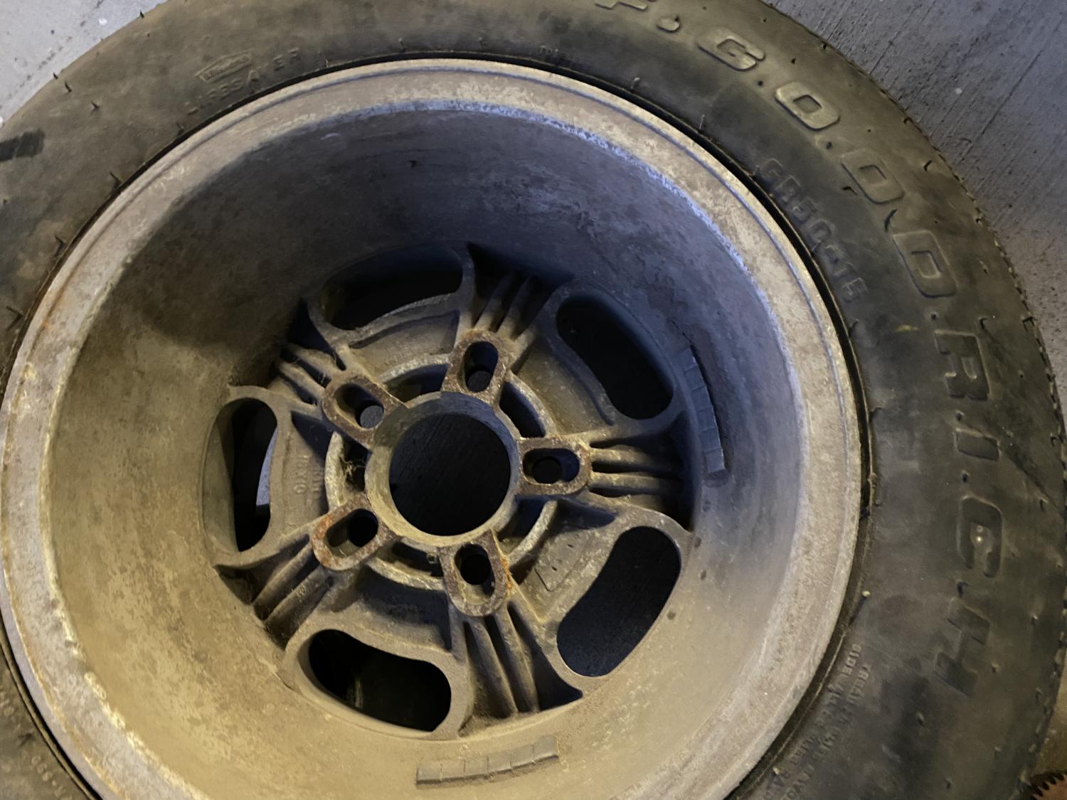

Here is the front rim off the car.

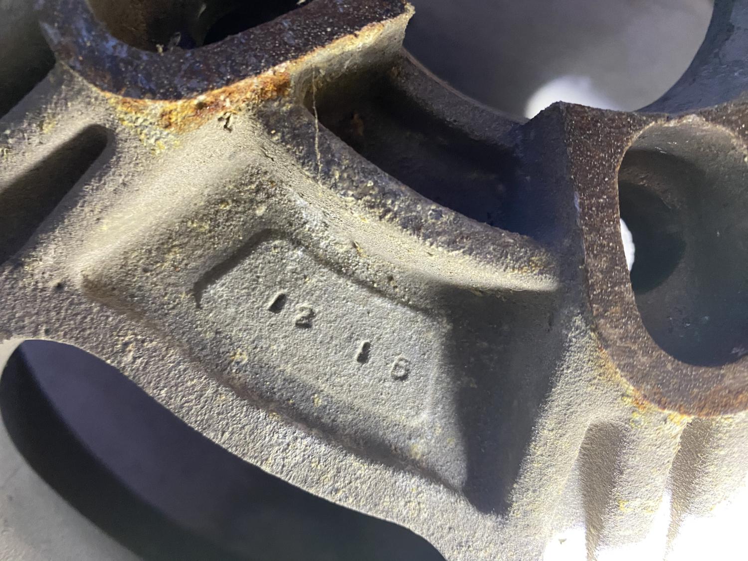

Clearly Ansen Sprint mags.
Is that a date code?
