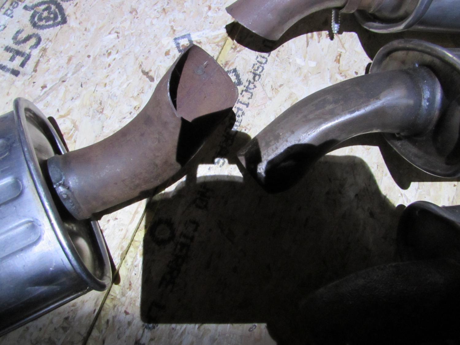

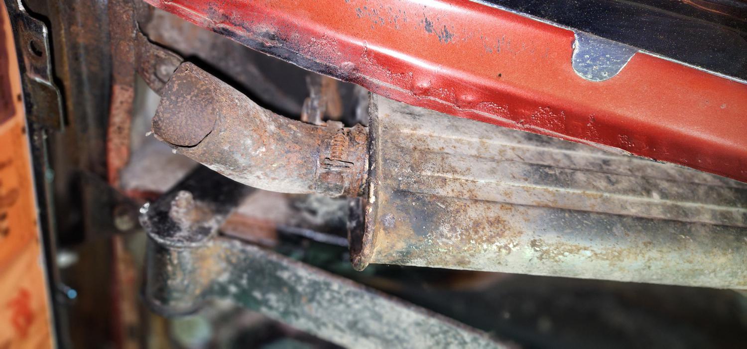

Looking for some advice on a 66L79 Chevy II I'm looking to purchase. Ive restored an L79 a while back and it fetched 207k at Kissimmee Mecum a few years back. I'm no expert on these cars but do know quite a bit about them. The car in question is a low mileage all original example. There are some things I don't know about. My first question is regarding exhaust resonators. I may have some other questions also. I've attached a picture of the right resonator. I have never seen and in all my searches I have not been able to find any examples of these. The car seems to have its original exhaust with the exception of its tail pipes which were replaced by it current owner due to being unsaveavailable
Like to hear your thoughts

The car still retains all of it's factory exhaust. Car has 2nd design double cut resonators. June car. Non original parts that I know of are 4 tires, fuel filler neck hose, master cylinder or wheel cylinder and oil filter I believe. Original spent battery is with car believed. Replaced brake parts are with car.
