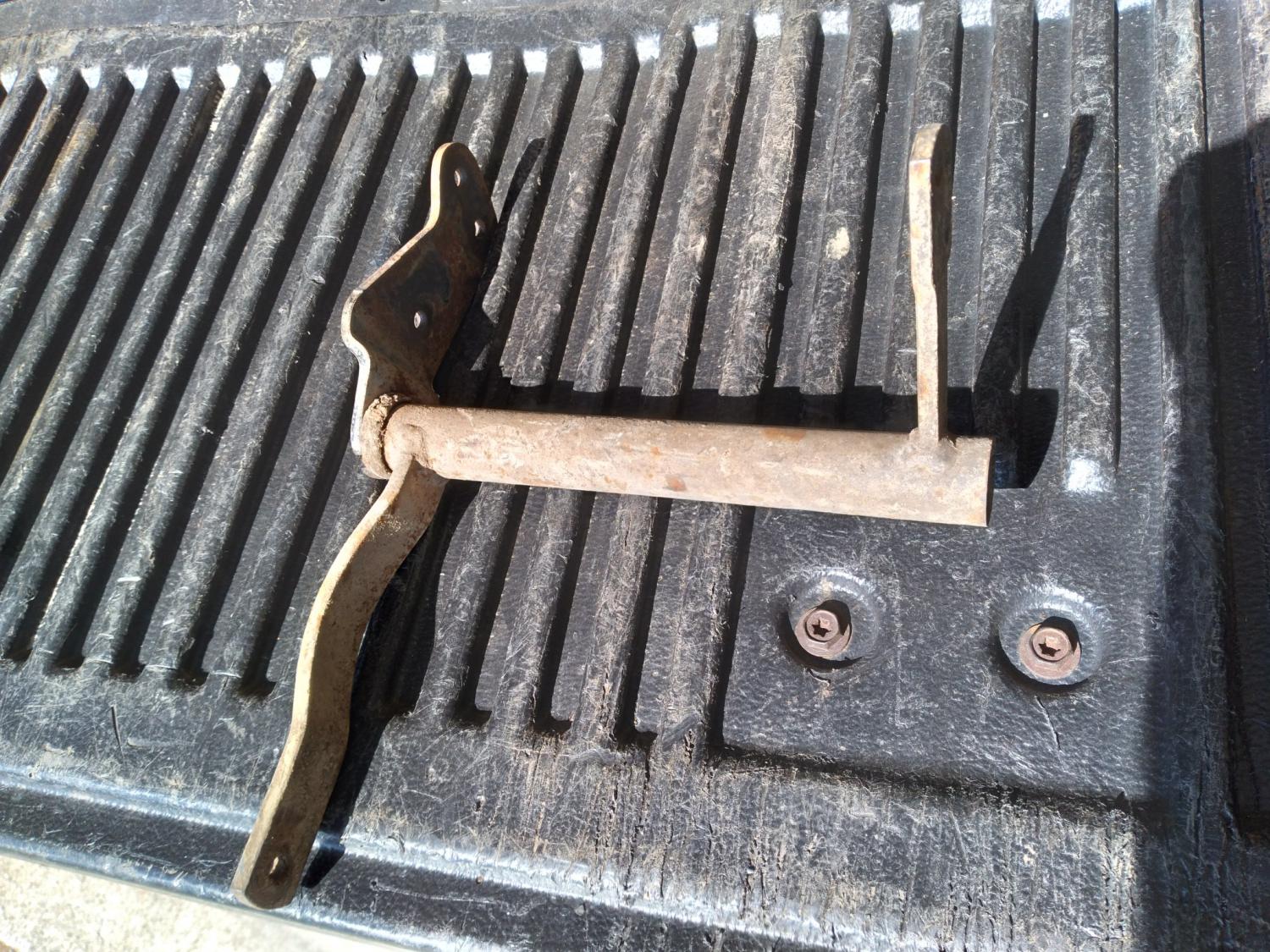

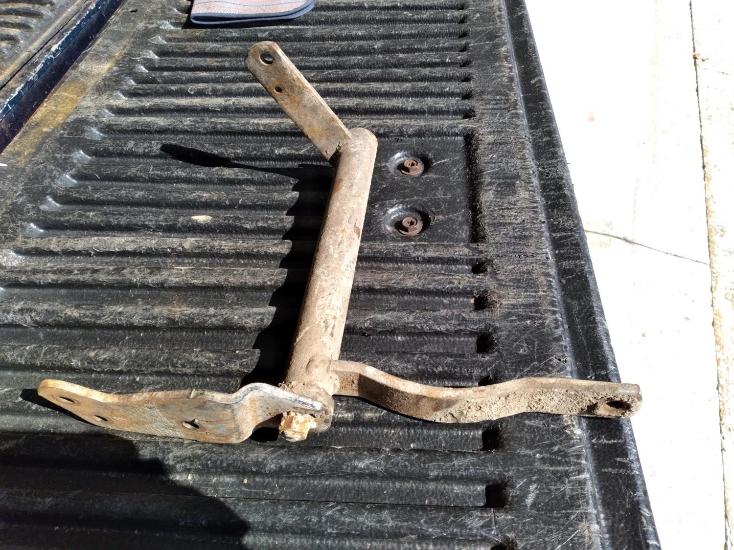

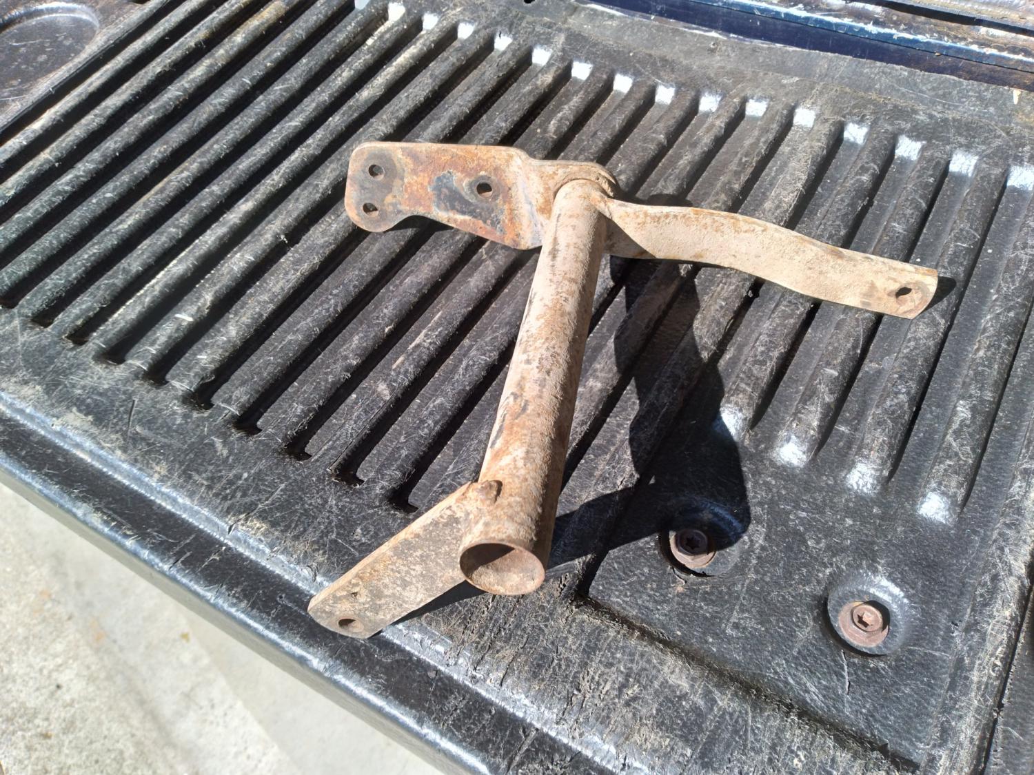

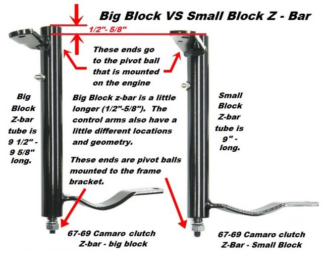

Can anyone identify this Z-bar? I believe it to be a Camaro, Nova with a small block but am not certain. The cross shaft is right at 9" long. Thanks for any help.

You are right...small block Camaro 67-69 and Nova I might have gotten this picture from a member here.

Thank you. I appreciate the confirmation.
